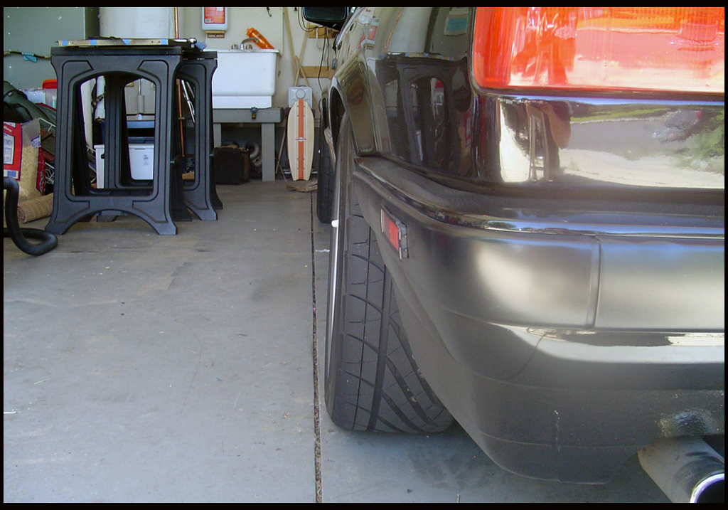

      Thought I'd update this for y'all, I got a new set of adapters today. Still a 20mm in the front, but I moved it up it a 25mm in the rear, to push the rear wheels out to match the fronts a little more closely. Here's a few pics of them in the process of installation:
      Adapter installed before installing the overlap-bolt insert:
      Overlap bolt insert installed:
      Rear wheel before, 20mm adapter, wheel at ET15 (note the position of the sidewall to the seam in the floor):
      Rear wheel after, 25mm adapter, wheel at ET10:

                            I'll explain it as best as I can. The adapter is held onto the hub/rotor face using the three 10mm allen bolts, and torqued down to spec. The insert is a solid machined piece of aluminum, with a threaded "bolt" machined on the back. The "bolt" threads into the last open 4x100 hole, and on the front, the threaded hole is offset to create the 5th 5x120 hole. Once all 5 wheel bolts are threaded into the adapter face, the insert gains its torque strength into the hub/rotor from the wheel lug bolt, and is absolutely unable to move or come loose.
