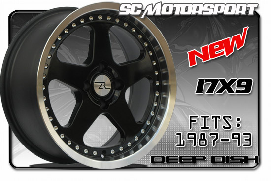

    thinking about ordered a set once i finish the m30 swap next week after my wedding
    they are 4 lug mustang pattern so 4x108
    they are 17x8 with 19 offset idk how it would work with getting the adaptors
    some of you wheel guys help me out
    love these wheels because no one on the forum has em and its something different
    and they are cheap $114 per wheel
  • skatingzooyork
    • 251
    Well the offset is perfect without adapters, if you ran 20mm adapters it would you at +1 offset which would be really pushing it on an e30. It's technically possible but you would need an skinny/low pro tire for a really good stretch and then most likely you would have to pull your fenders.

      They'll fit real nice, stick out about .5" all around. Thats with a 20mm adaptor

        so with a 20mm adaptor they be perfect
        what size tires???

            20mm adpaters put it at et -1 which is definately doable, but will need stretch and pull, and proper ride height to pull it off

              Damn, those aren't too bad looking. Definitely going to need some serious fender work, but if you get it right, they'll look insane!
                I misread and thought they were going to be 9's in the back. They'll still poke half an inch up front, but the back will be just about even with the fender. Run 205/40's all around with just a small roll and a big drop and it should look nice.
                edit: I didn't misread the pic says they're 17x9. Do they come in both sizes or just the 17x9's?

                  how about having your rotors drilled and your hubs re-drilled and tapped. That way you can run both 4x100 and 4x108

                      vdubbers, honda, and 240 guys do it all the time

                        so i could just redrill my hub and rotors
                        they make them in
                        17x8 19mm offset 1 inch lip
                        17x9 20mm offset 1.6 inch lip
                        17x10 25mm offset with 3 inch lip
                        wish they made these in 4 lug

                          dewit. make sure you do it right or it'll just look like crap, and that phat lip won't save you.

                            ok give me couple weeks i will order a set and redrill the hubs and rotors and do it
                            in the middle of doing a m30 swap right now and gettin married this weekend too much going on
