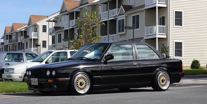

          offsets change depending on the width of the wheel, so you're going about it slightly backwards i think.
          you're right that 10.5 is too much.
          just for reference, this is my car at 8.5et11 front and 9.5et9 rear. these offsets have the fronts at a hair past flush front and a bit more past flush rear.
          if you swap the 1.5" lips to the front, 8.5 et15 or so will get you flush, so 20mm adapters or so.
          in the rear, i wouldn't go more than 9.5...which would mean a 2" lip and put you at et33 before adapters...so 20mm adapters rear would get you about flush, and you'd still have a minimal but comfortable level of inner clearance.
          p.s. i'd also recommend 205/45s up front and 215/45s out back for your suspension setup.

              205/40 and 215/40s on FK konigsport coilovers, which at that height are probably 2" lower than your proposed set up will go.
