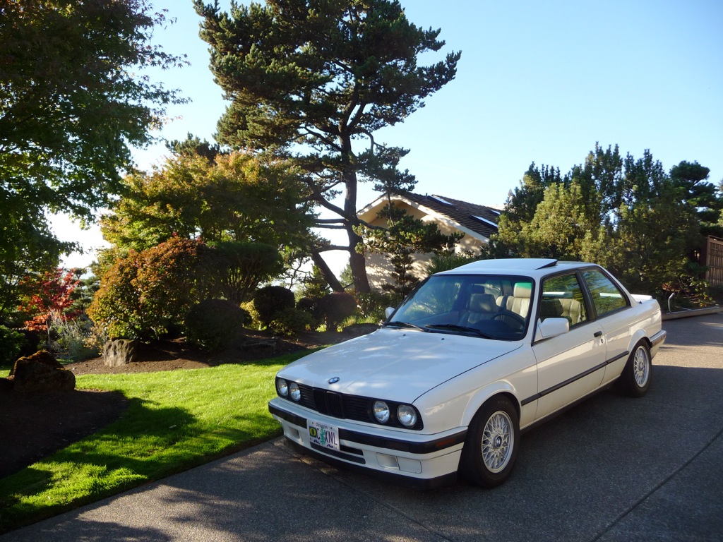

                I'm planning to do the same thing, Kamotors is the best example, 20mm spacers all around. The same would work for the basket weaves.
                Kamotor's Car w/spaced b-caps:
                I'm looking at buying the 15 or 17.5mm spacers, still haven't decided, from e30Rob in this thread. Then I later plan to find some Style 5s (et23) fill and re-drill them to 4x100 and then machine down the spacers to about 10mm.

                      I'm running Billy Sports, H&R Sports, e90 spring hats, and 20mm H&R Spacers front and rear. Had to roll all four fenders to avoid rubbing.

                        Have any different angles? I'm curious to how much I would have to roll my fenders if I go this route.

                            If your car is lowered, you'll need to roll with 20mm spacers.

                              I'm lowered on billy/IE3s with 15x7 weaves at et16 front / et11 rear (with spacers) and I have no rubbing at all. 195/60/15s
