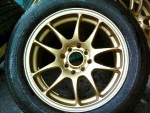

Spotted these f/s locally, will they fit???
  • tomwas
    • Dec 2010
    • 387
    They are a universal with a 4x100 fitment, they were on a 98 Mitsu mirage, will they fit my 87 is without spacers etc??? They are 15 inch DR31's with almost new tires......

    find out the offset and center bore

      Offset is 40 , not sure what the bore would be on them......... Still researching.......

        The rear will fit and look very sunken in.
        The front won't clear brakes.

          Saw some rims on tirerack with 40 offset for 87 is's, would these have that great of a difference so as not to fit properly??

            I'm sure someone will correct me if I'm wrong, but your gonna need at least 20mm spacers/adapters to make that work right.

              you'll want your offset to be around 20 or lower. if your center bore is larger than 57.1 you'll need hubcentric rings. hope that helps
                  Correct and Correct...
                  20-25mm Hubcentric spacers will make them work...
                  check out the ASK ALL WHEEL/TIRE FITMENT QUESTIONS HERE THREAD http://www.r3vlimited.com/board/showthread.php?t=83125 By Mystikal, A-lot of help there!
                    Tirerack includes a spacer when they sell et40 wheels for an e30.

                      What's the width? 15mm spacers will work as well.

                        Not really sure what the width or center bore is, they looked good in the for sale ad and were a good price for rims and tires.. Thought they would look good on my delphin coupe...
