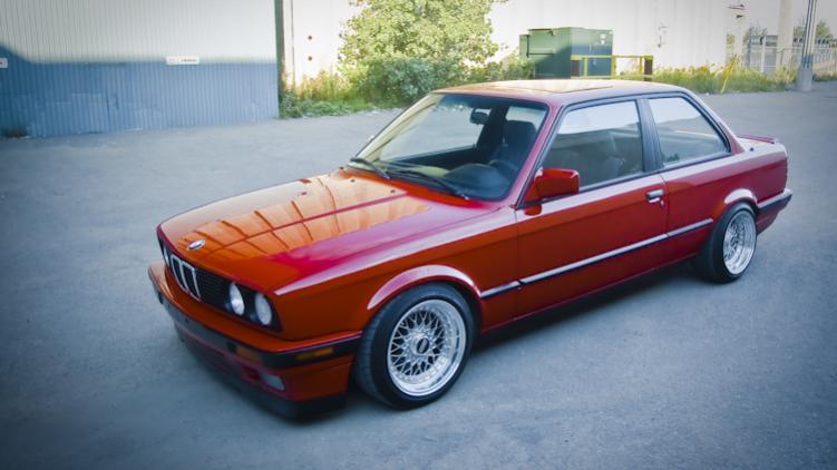

                  i am a bit basic, i like my big lips :P i've got a set of BBS RS036 in the exact same sizes as you, 15x7 +25 and i am planning to go 2.5" and 3" lips to acheive 15x8.5 +6 and 15x9 +0. This will require some stretch and camber and going real low.
                  just another option :) try to find the topic by Jim Lepage. His red E30 has the same sizes as i posted above to give you an idea of final product

                      15x8.5 +6 (2.5'' lips) and 15x9 +0 (3'' lips) with 195/50-15

                        looks amazing, but seems like quite a tire stretch.

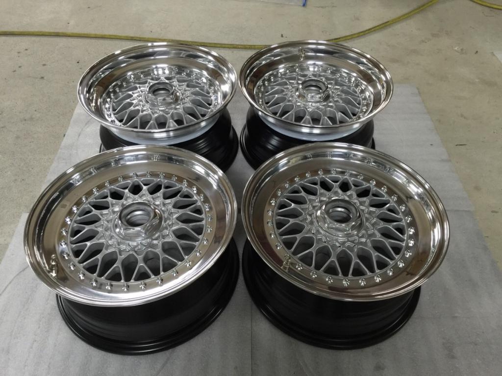

                          I'm in the process of refinishing a set of 2.5" step lips right now if you need some visual reference. These wheels will end up 16x8 +13 in the rear.
