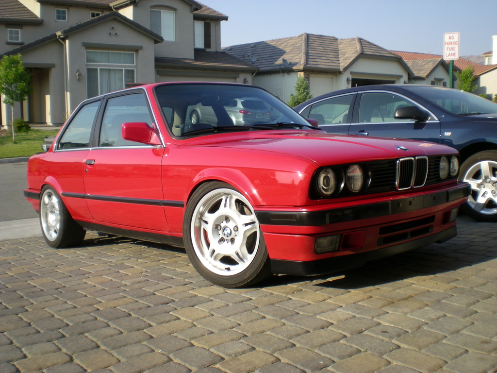

    8.5 E36 M3 LTW
    1989 332IS -S-Fiddy Four-Some weight removed.
    5 lug E36 M3 Brakes Coilovers and LTW's and No ABS.

      ^^^ How's the clearance with and without full lock?
      What's the offset of those wheels?

        Offset is 41 with the 318ti Rear setup and E36 M3 Front. I run 235's on the front and no rub at full lock with 12mm spacers.

            Awesome! I'm looking into getting a set for my car too, on my Style 109's (et46 17x8). Not sure if I want to go 245 all around or just on the rear.

              If you're non-staggered, I'd run 245/35 at all four corners.
              Unfortunately, 245/35 won't work with my offset, didn't think it would, but wanted to check anyway.

                That looks good! I wish that you could get those wheels onto an ix.
