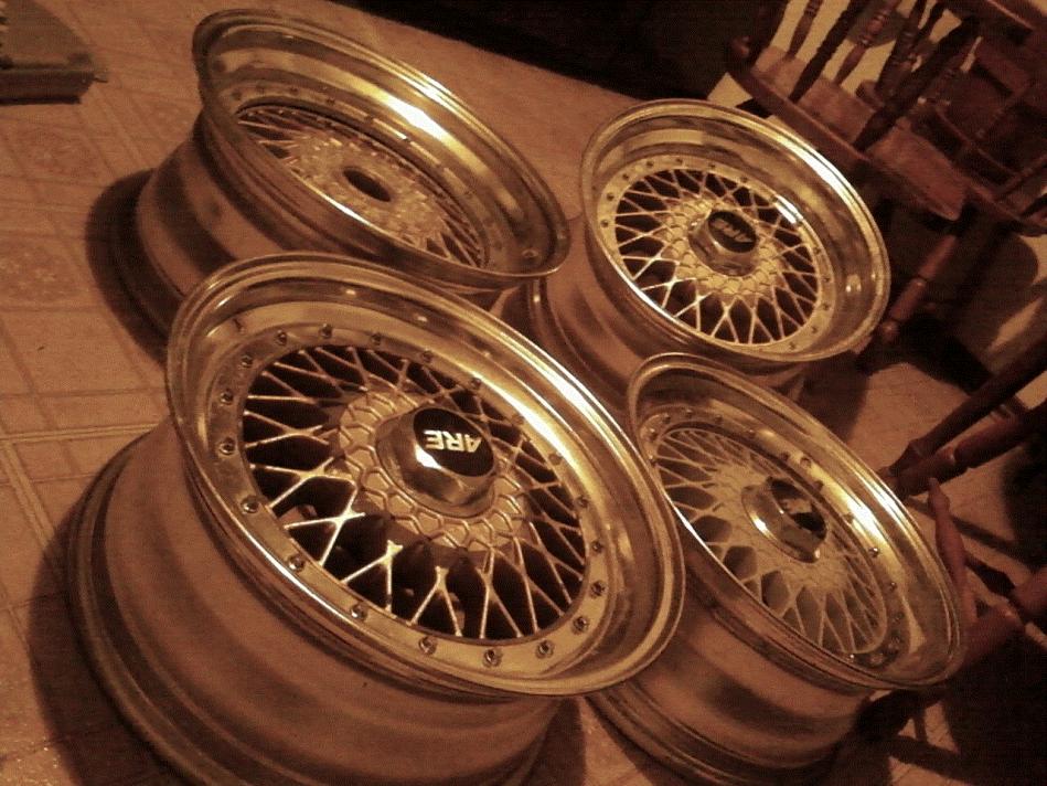

          here we go... actually wheels are 17x8 rear and 17x7 up front (guy was measuring by very outside of wheel)
          anyways they are et13 for the rear and around et20 for the front... scary thing is they are 5x130 so i'm gonna have to run 20mm adapters, putting the front at 0 the rear at -7!!!
          not sure if there is a way i can offset this to make it nearer to 0?? I'm considering taking the centers to a machine shop and having them shave off some mm's from the back? anyways onto the pic (doesn't do it justice)
          also need one more center cap that screws into the wheel no idea if all the center caps on ebay are like this or not (i think most of them are just one piece)
          and wheels only ran me $325. but they really need to be refinished so i think it was approp price.
          • Pabl0
            • Jan 2009
            • 47
            we make adapters in 18mm, not that it helps much lol also shaving backpads is almost impossible with most wheels because you're taking away material needed for the lug bolt. there are on occasions that wheels like merc AMG wheels have really thick pads but most wheels dont allow enough material to be removed that it'd make a difference. fill n drill will be the best best as it would be cheaper and offsets would be more suitable as is.
            • sdub
              • May 2011
              • 220
              ^^^who is we??? I definately will pay for even the extra 2mm's.
              but it wont be as bad as i thought to fit, thinking i'm only going to be running a +6 offset in the end since wheels is only 8" wide.
              anyways lmk where to get them!
