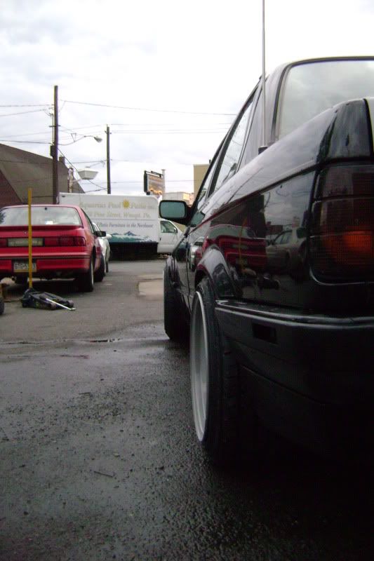

              Ok. How much poke did they have? I have a pictures of my car to see how low it is. The back is about an inch and a half lower and is going a half inch lower and the front is going an inch lower than it is now

                I will answer this later when I get back home and post pics.

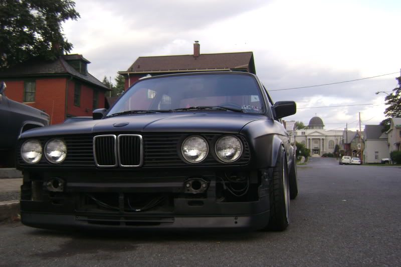

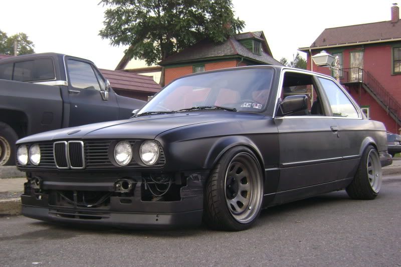

                    This is 16x10 and 8 with 215/45 and 195/40 rear had a little rolling with a bat. front had the pinch on the lip smushed and camber set in.
                    on a early model.
                    Like I said, 16s look much better. :)

                      that does look amazing. are those 16s or 15s? Is that 4.5 inch backspacing on the 8 and 6 inch on the 10 like you posted above?
                            Yup, 16s and yup, 4.5 on the 8s and 6 on the 10s.
