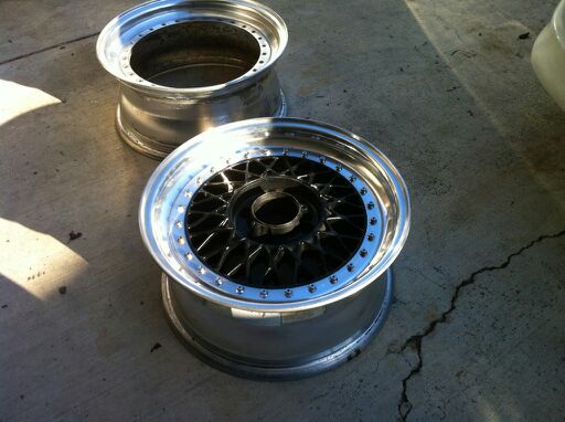

    my new wheels. need help with offset.
    i just picked up some new wheels.
    they're ARE 398 2 piece wheels.
    16x7 and i measured a 5.5" backspacing (back of the mounting pad to outer lip) which puts offset at et38 according to the online conversion chart.
    i have to get adaptors since they're 4x108 but what final offset should i be looking for?
    car is a 87 vert lowered on jom suspension. daily driver. front fender lip got pushed out a little from current wheels so im going to be rolling the fenders anyways.

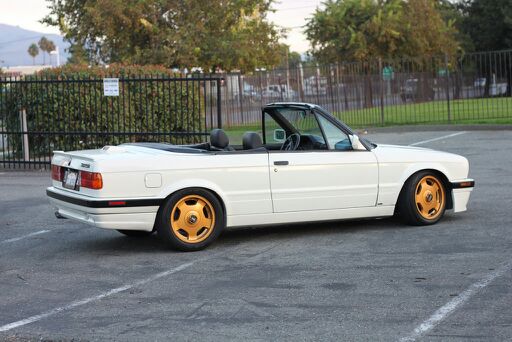

    also, there getting dropped off for fresh powder coat and lip polishing. what color should i go on the centers?
    im thinking black with gold flake.
    here's a pic of the car they're going on.
    Sent from my SAMSUNG-SGH-I727 using Tapatalk
    • kennyvb
      • Oct 2011
      • 404
      Something around +20 would be good.

      • kalib0y
        • Dec 2004
        • 3620
        +20 or +25 is a good offset to go for

        • Holland
          • Nov 2008
          • 7178
          For 7" wide, I would say anything from an et20, for a nice stock looking setting to an et10, to be more flush. Might have to do a mild roll for et10 though.
