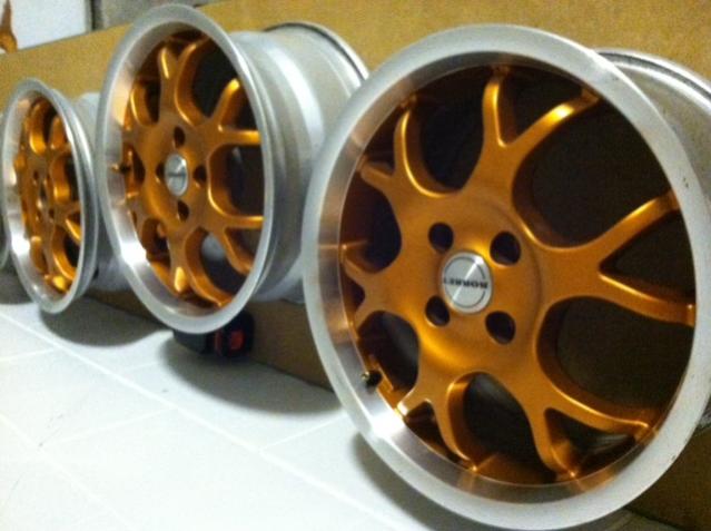

                          • david2991
                            • Nov 2011
                            • 315
                            Who in gods name would ever paint these wheels... But the price was too good to pass up so they are going on the e30.
