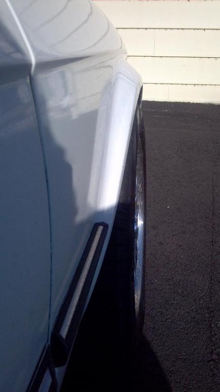

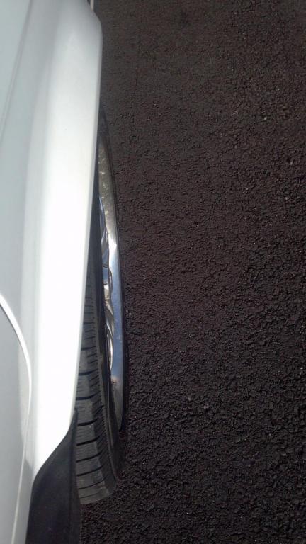

                I am et5 in the rear and et4 in the front. 195/55 and sorry for the crappy cell pics.
