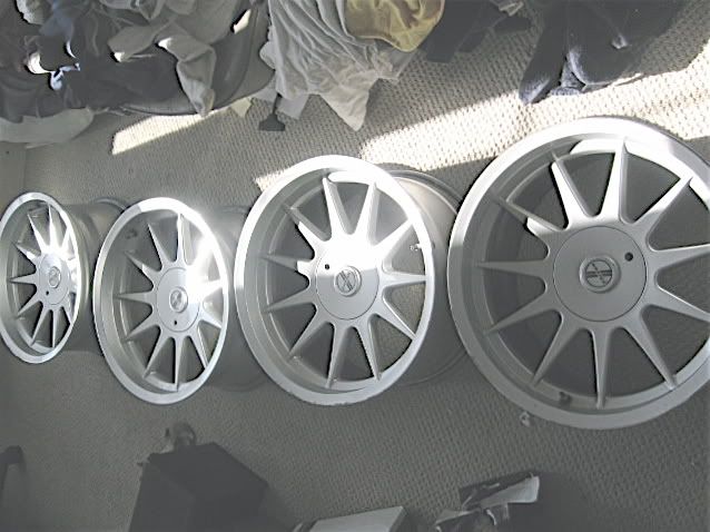

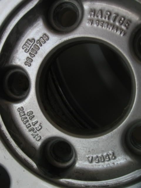

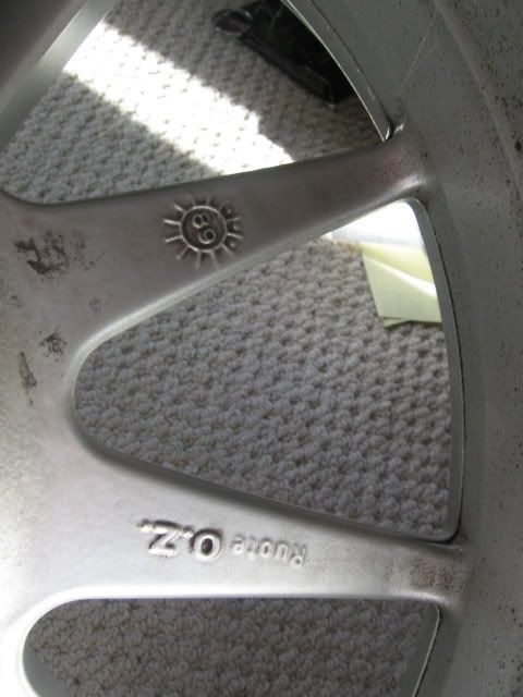

    Ive always loved the classy styling of the Hartge wheels and I came across these. They are 17x8.5 with a +13 offsetand were originally off of an E34 535i Hartge H5. They basically look like the one piece Hartges that we commonly see but they are more concave and have a bigger lip.
    Does anyone have these mounted on their e30? Pictures?
    Also, how gay would it be if you were to run these with 18mm adapters with a final offset of -5? I know itll be borderline hella flush/mexi-poke but does anyone have any pictures of similiar sized wheels and offset mounted to their e30?

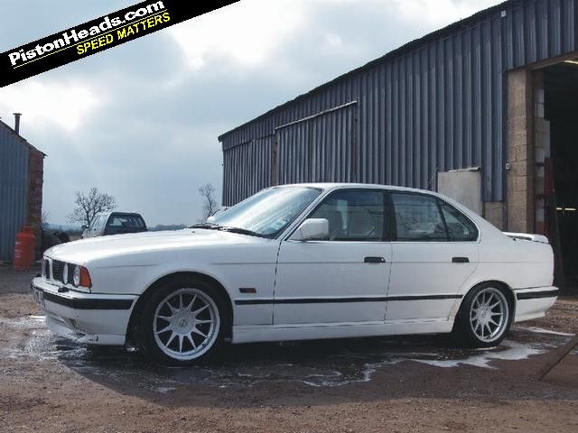

                  ive got 17x8.5's on mine and its pretty flush with 20mm+ offset. Running some 8mm spacers now to clear the coil overs properly at the front, so I reckon 13mm would be just about perfect. Maybe look at converting to 5 stud if you want to run them?
                  Just a little project im working on
                  - http://www.lse30.com -
                  • e46s54dr
                    • May 2008
                    • 1059
                    Thanks for the photo. Ill probably just save them for another project. I just got coilovers and a wilwood brake kit for the 4 lug so I don't wanna start over with a 5 lug swap.
