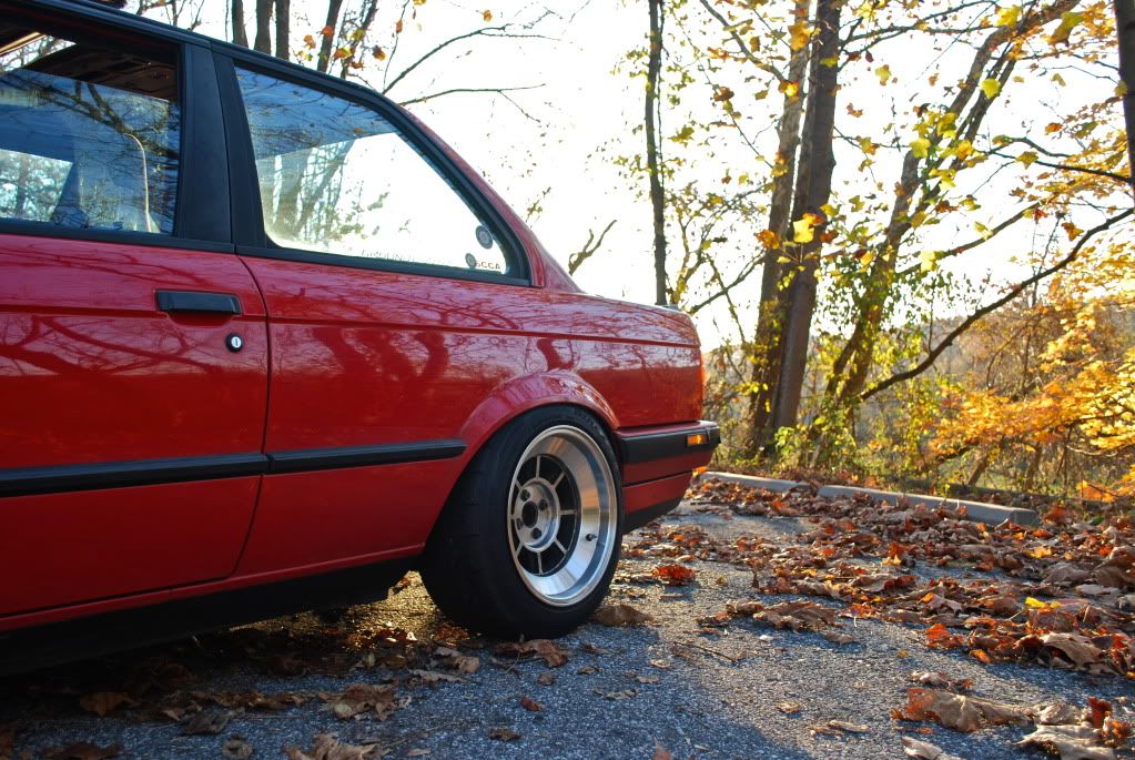

    15x9 et0 rear with 195/50-15

      damn that looks great. what are the specs on the front, and what kind of tires are they? also do you have anything to correct camber in the back?

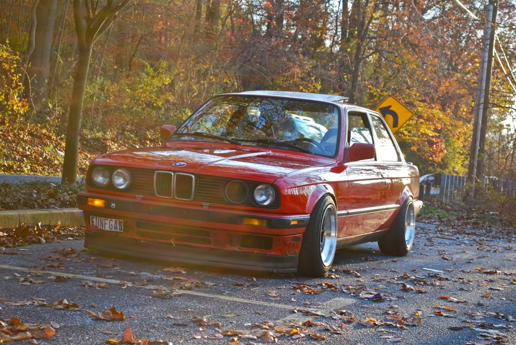

        15x9 +0, 205/50
          Fronts were 15x8.5 et06 with 195/50-15 Dunlop dz-01
          No camber correction at this time.

            what did you guys do to your fenders. just a nice roll or did you cut it out? and if you rolled it how was it cause i heard rolling the rears was a pain in the ass because of how thick the metal was

              I scraped the sealant out of mine, and pulled them about 1/4 to 1/2 inch. I used purely a hammer, so it took a LONG time to perfect and do.

                how would a normal fender roller work? or ive also heard of people just cutting the fenders. how hard would that be if i just resealed it or clear coated the open metal?

                  A normal fender roller could work, even better in fact. Your best bet is to take it to somebody to have them rolled, or tackled them yourself but go slowly. You could definitely cut them, but rolling is definitely what I would recommend.
