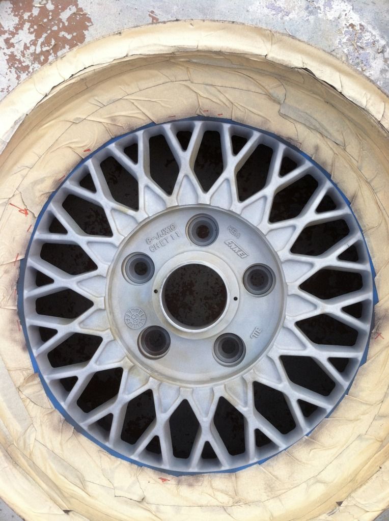

      Next step was to mask off the wheels. The most important part of this is to use a top quality fine line masking tape. I used the 3M vinyl strip because it is the easiest to work with and will work with powdercoating.
      Then i masked everything else with some cheap tape so i could sand blast the centers
      All blasted
      I did just one wheel to start with to make sure i liked the color. It looks pretty good to me. I mounted a 225/50/16 with hand tools. I slipped and put a ding in the lip.

        What sandblaster are you using/what compound?
        The polish looks great! Hard to tell what color that is though...

            I'm using black oxide in my HF cabinet. I like the glass bead better but it takes longer. The color is black chrome
