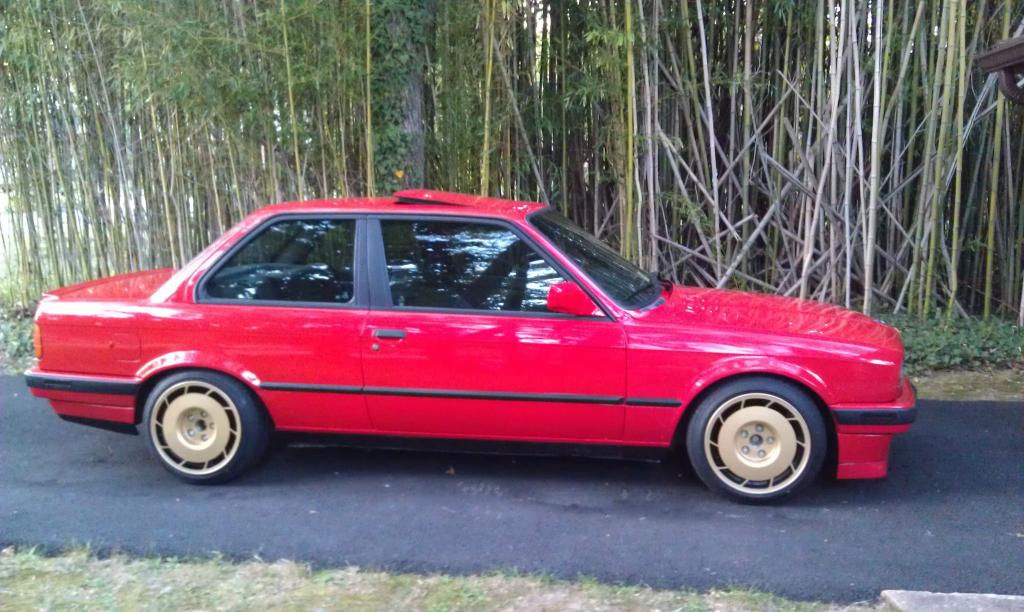

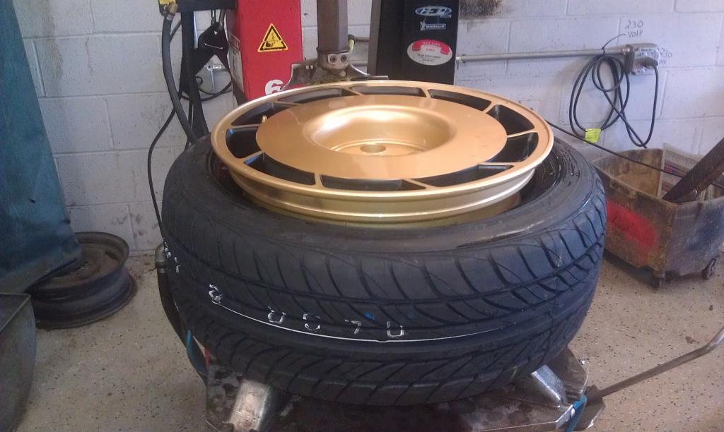

    I picked up some staggered salad shooters and had them refinished in subaru gold. I just mounted brand new 205/45/16 tires all around. These are going to look awesome! Now I just need adapters. :)

          Looking at your sig, it looks like your gonna be tucking some in the back. It sure beats white. But then again, I think your car looks great just the way it is...even with the 14s.

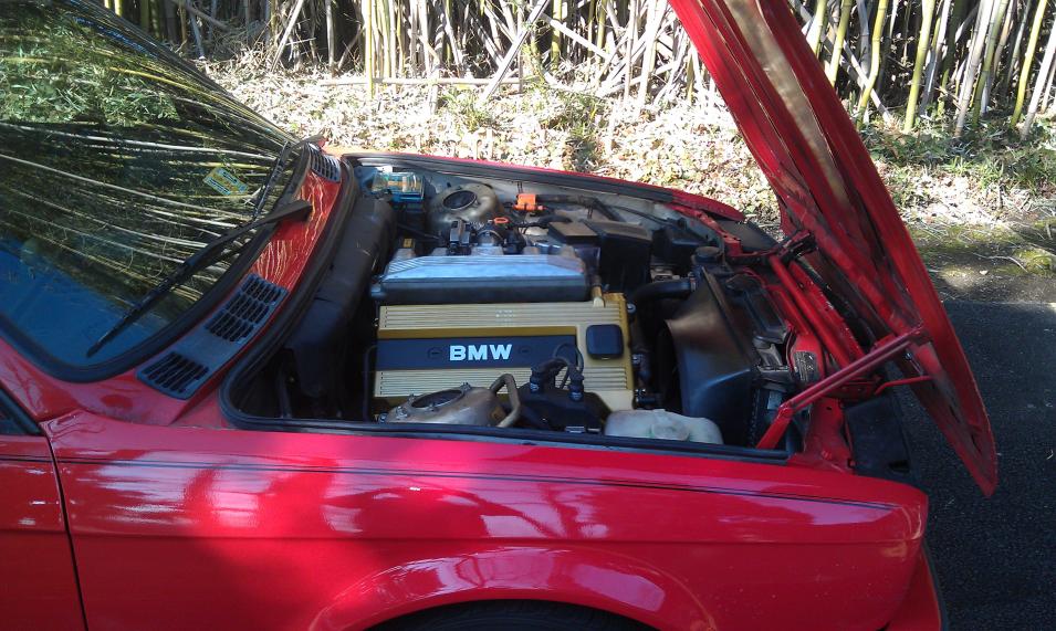

                  Yeah that woulda been awesome! Here is a better shot of the finish. And they'll match my valve cover

                      makes me want to pick up some local salad shooters and PC them gold. Damn it

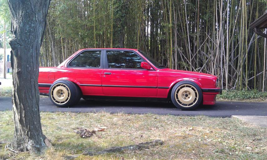

                              well here they are guys! I think they look awesome but I need to go lower now haha. :)
                              Adapter Specs:
                              Front: 18mm 4x100 (57.1) > 5x120.65 (70.3)
                              Rear: 20mm 4x100 (57.1) > 5x120.65 (70.3)
                              Wheel Specs:
                              Front: 16x8.5 et32
                              Rear: 16.9.5 et38
                              Tire Specs:
                              Falken Ziex ZE-512 205-45-16 Front and Rear
