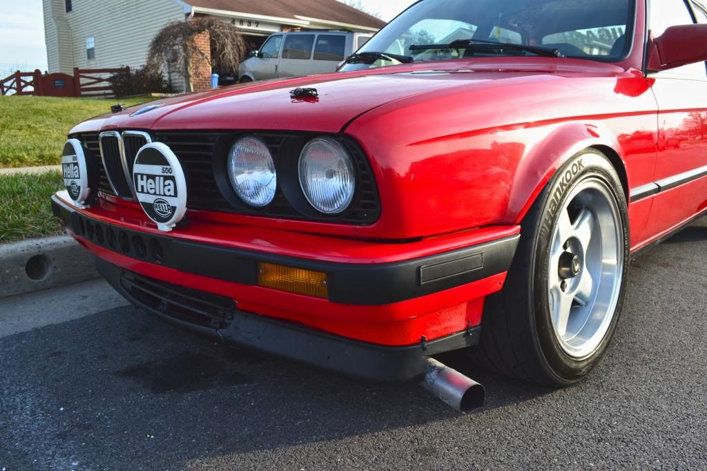

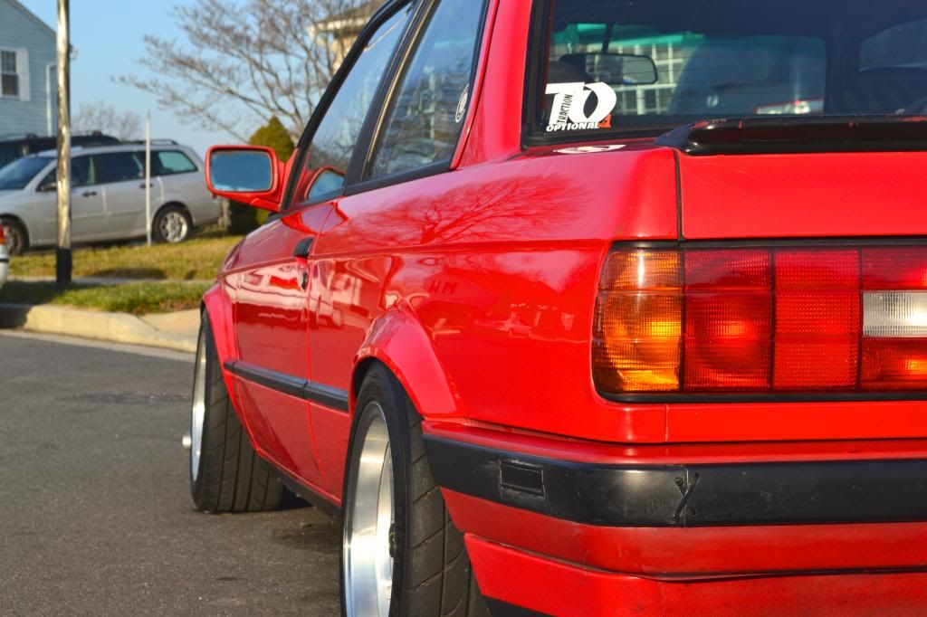

    So I've read a lot of posts in this thread and I gather that 15x7+17 up front and 15x8+17 in back would require pretty narrow tires (~205) and/or fender rolling. Based on the picture above, however, it looks like they should fit fine with 225s.
    My car is not as low as the one pictured above and it has high (early) rear fenders. Do you think I will have an issue?
    The fenders on that car have been rolled. By the looks of it, the front have been rolled and pulled.
      Thanks, I assumed that much. I had gotten the impression that wouldn't be enough.
