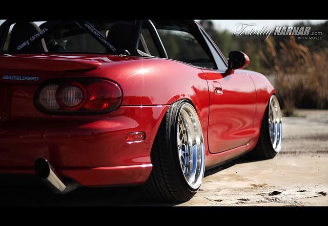

        I can't say for sure, try asking Mystikal.
        However, these are 9.5's that are nearing et0
        I wanna say those are 205/45's though.

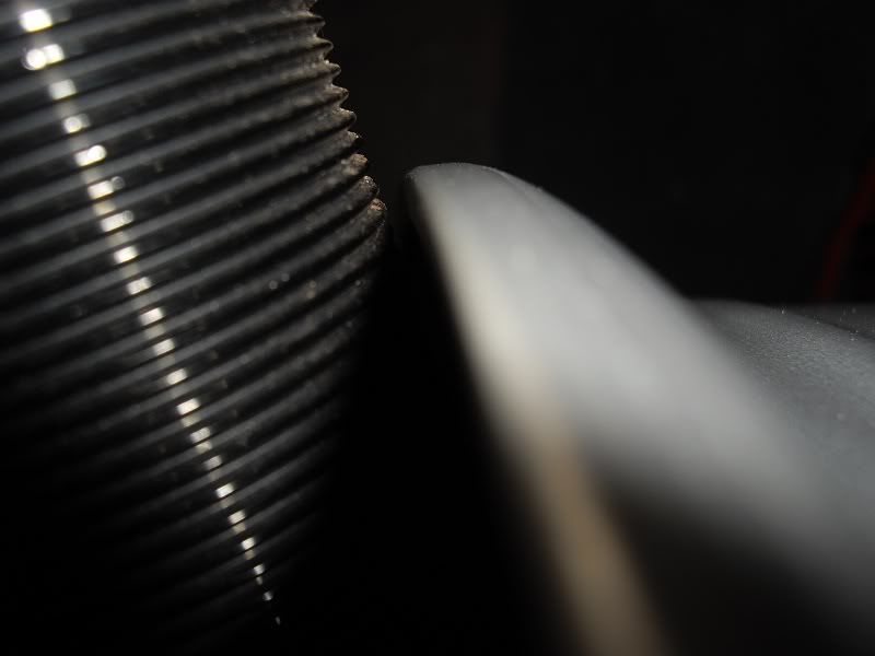

          Depends on the wheel backspace. My 17x9's in the front would never have fit a tyre under there with the stock struts. With the coilovers they cleared by like 3mm.
            Yeah they look a little taller then what i am going for. But those wheels are square right and not staggered? And going to send mr mystikal a pm shortly. Thanks for all the help.
            I have bc coils so I am not as much worried about that end of the wheel as i am about the fender.
              Afaik I think those are the 8.5/9.5 staggered setup

                  Turns out that, with adapters, the rears on that red car are 16x9.5 et13. So, et0 is gonna be quite aggressive haha.
                      Nooooooooooooooooooooooooo
                      Does that car have any spaces at all?
                      Well, by nature, rear salad shooters are 16x9.5 et38 and he has 25mm adapters in the rear. Therefore he has an effective offset of 13mm. With a hard roll and pull you might be able to pull it off.
                          So do I, there is no way mine would have fit in the front without a spacer.
                          I also doubt they will fit on the rear without rubbing on the guard. My wheels are 20mm + offset, with an 8mm spacer in mine, it rubs under large compression with a 215/45R17 on it. So yours are going to be even further out towards the guards if you have a 0mm offset.
