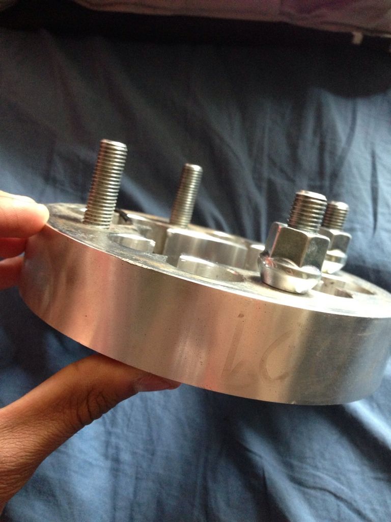

    Well I'm 95% likely going to need to get my adapters machined down a little bit (offset right now is at -2, 7.5" wheel, 205/45/17). But I can't machine the back, and the front has studs sticking out. Do they just slide out after a few taps with a mallet? I'm pretty sure they're adaptec's, and any help would be appreciated. The fronts may be fine, but the rears will most likely need to be machined to fit. And here's a couple pics:

              To answer your original question, yes, the studs will just press out. Get a piece of tubing or a deep well socket and set the spacer on top with the back of the stud centered over the tube/socket. Thread a nut partway onto the stud to protect the threads and hit it with a hammer. Stud should come out. A press works as well if you have access to one.

                    The more important question is how thick the adapters are. "Safe" adapters are only made down to 18-20 mm for a reason. If you are planning on thinning the thinnest adaptec adapter you may want to rethink the road you are choosing to go down.
                      You strike me as someone who genuinely cares that his wheels stay attached.
                      They're 32mm, and the most I may shave them down to is probably around 25.
