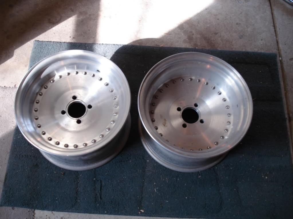

    Does anyone know If its possible to fit a 4x101.6 on a 4x100, could you grind down some of the inside of the bolt holes to make it fit? I would like it fit these on my car

    Wobble bolts. Make sure the centerbore is bigger or equal to 57.1 though.

      Haha, what specs are those?
      But yes, you can use wobble bolts.

        couldn't hurt to get them properly sized to 4x100? never used wobble bolts

          They don't appear to have a standard bolt recess. Your not going to have much of a mating surface to torque the bolts down.
            Well I found them here haha
            Pale Blue Eyes - Velvet Underground
            Then did some research and found this set
            I think they would look really sick and give a nice aggressive stance.
