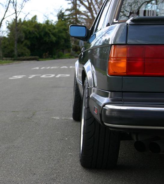

          20mm offset for a 7.5" wheel would be great for front. IMO, 10-15mm in the rear would be a lot more flush.
