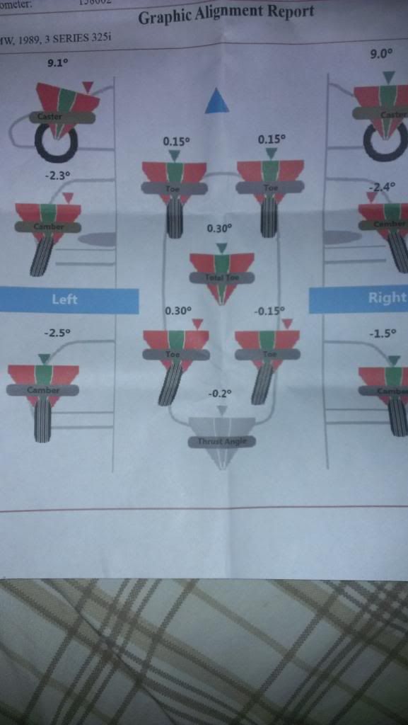

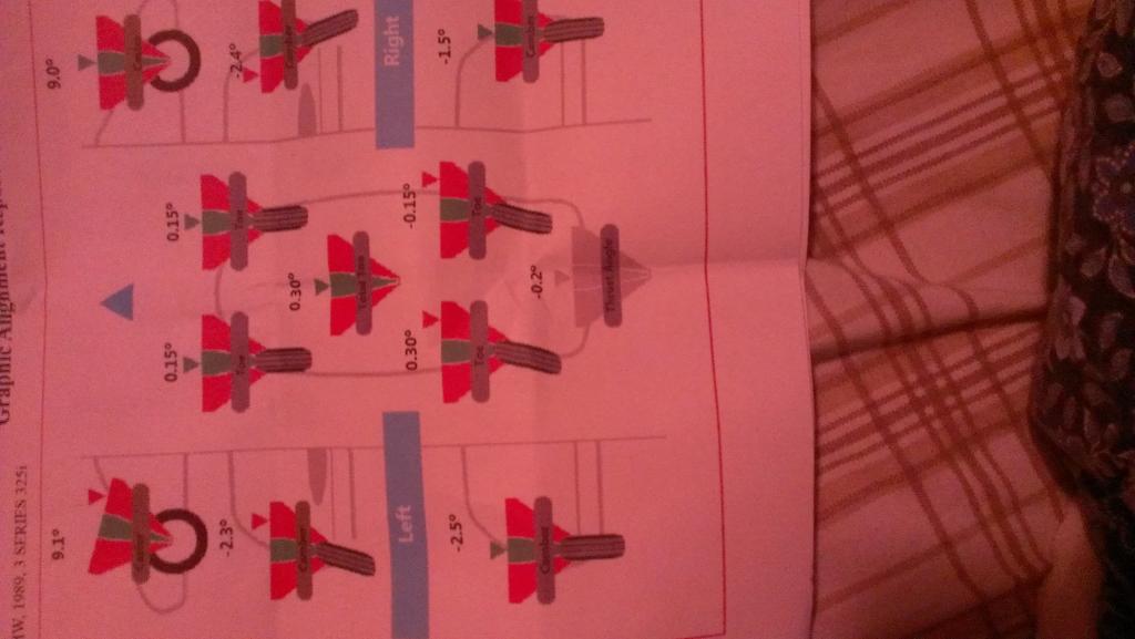

            Okay i see what you are saying. The place i got my car aligned was okay. I mean it was only $50 but i guess i couldve went to a better shop. Here's a picture of the print out they gave me. What would be a decent camber plate should i get coming from you guys' experience?

                Thanks for posting that printout, it helps a lot. First, a soapbox moment:
                Typical printout for a garbage alignment system. Your thrust angle measurement is not coherent with your rear toe specs. The front of your car will track straight while the rear of the car is trying to track to the right. With the measurements they have there, your thrust angle should be .15, not -.2. Instead of correcting thrust angle by setting front toe to counter act with rear toe, they just set front toe to spec and left rear toe to drag your tires to pieces. This is common not only with a cheap aligner, but an alignment tech who doesn't take the time to do the job right. You get what you pay for I guess.
                That being said, this is pretty good news for you. Basic alignment knowledge (that your tech should have figured out in just shy of half a second) is that ride height affects every angle of alignment. Since there is technically no adjustment in the rear of an e30 stock, ride height is the only way to correct any deviation from right to left. Having adjustable collars in the rear means you can correct a lot of your issues.
                Since your passenger side toe and camber are less negative than your driver's side, that tells me your ride height is uneven in the rear. My guess is that your passenger rear is higher than your driver side rear.
                Take your car to a reputable shop that has a HAWKEYE ELITE alignment system. This is important: Tell them that you have an adjustable coilover system on your car and you need a live ride height measurement using WinAlign tuner. This will give them the chance to adjust your suspension accurately and will likely even out your rear toe and camber.
                Your caster is fine for a lowered e30. High caster is not a tire wear angle, but does promote stiffer steering and better high speed stability. E30s with M3 offset bushings will show anywhere from +10 to +12 degrees of caster.
                Your front camber of -2 to -2.5 is fine as well. I'm actually surprised to see that much negative camber without camber plates installed, which makes me question the accuracy of that alignment machine.
                Front toe should be closer to 0, rather than factory specified as they have done. When your car is lowered the suspension does not move nearly as much in dynamic as it would stock, so 0 toe would be better for you. The only caveat is if your spend a lot of time highway driving, which would mean you need to stay closer to stock specs. At higher speeds, your suspension will open up more creating toe wear. This is known as dynamic where as a suspension at rest is known as static.
                The most important thing to note is that you want toe and camber to be as even as possible on both sides. When you have different measurements from left to right, this is the biggest killer of tires. I would recommend a camber correction kit for the rear before camber plates up front...unless the readings on that alignment are crap and your next shop tells something different.
                If you want to drop the cash on camber plates for the front, go with Ground Control or Vorshlag. If you're on a tight budget and just want basic correction, Cosmo Racing makes an acceptable plate that should last about a year or more with regular driving.
                Hope that wasn't too much info! Feel free to PM me if you need anything else.

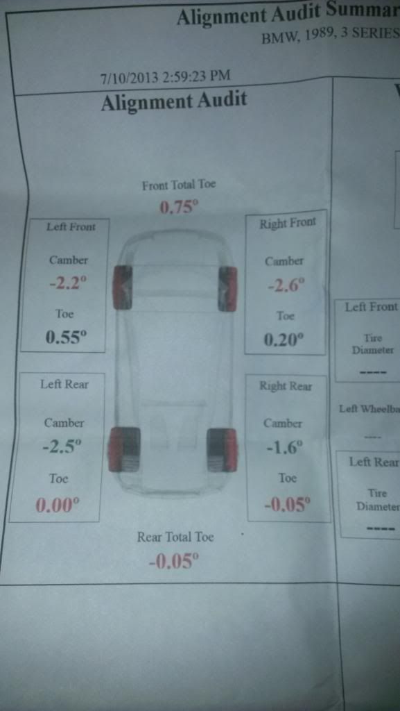

                        What do you say about the weld on with eccentric bolts to subframe that i see for sale? would those help? just seems a lot of work to be done. By the way i posted up the wrong print out of the alignment.
                        this one was before the alignment
                        and this one was after
