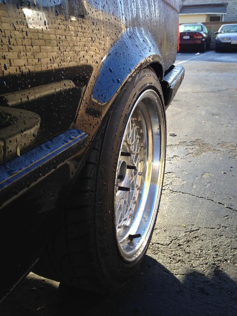

  • illest318i
    replied
    Fronts poke out a teeny bit because I have spacers to clear the coilovers.
    My fronts have a stretch on them btw 205/45
    And my wheels were turned so that's why they look like they poke out a lot

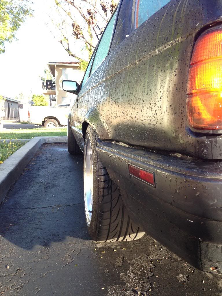

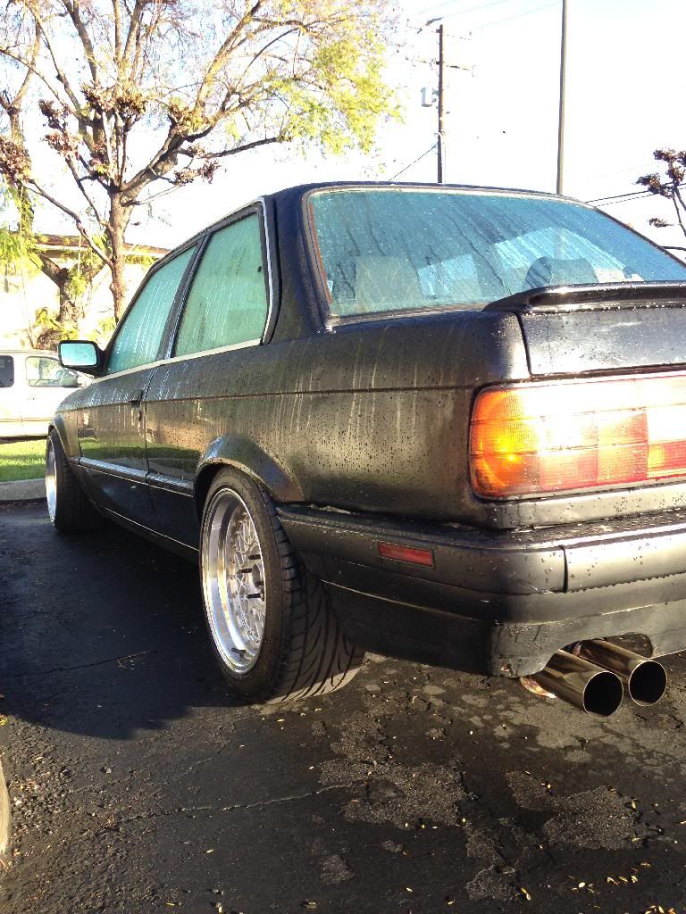

  • Wasefi
    replied
    Originally posted by illest318i
    Offset on mine are et20 all around.
    225/45 in a 16x9 wheel in the rear.
    They are just rolled flat, not pulled.
    Crappy pics, but you get an idea. Let me know if you have any more questions.
    Sorry to bother, but any photo's of the front? It seems like it pokes out just a little bit and im assuming thats fron the rim being a 9 right?

  • illest318i
    replied
