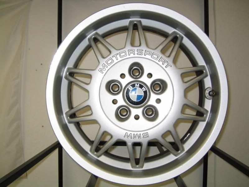

    Going to be painting the lettering on a set of DS1's in black.
    Don't really want to attempt to mask it off and spray it, what's a good paint with a brush that I could use to paint this?

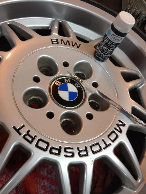

    Just use some really thinned out paint, get a decent size brush, let the paint soak in, dab the letters lightly and let the fluid do its job.
    It'll probably take quite a few layers though

      Wow I work slow. Haha
      Oh well just finished the first one. I definitely don't have the steadiest hands but I have a tiny paint brush!
      Yay or nay?

        I think it looks really cool!

          I was gonna say black thinned two part epoxy in a syringe on a level surface...

              I like the syringe idea, wish I had thought of that sooner

                yay for sure, looks good!
