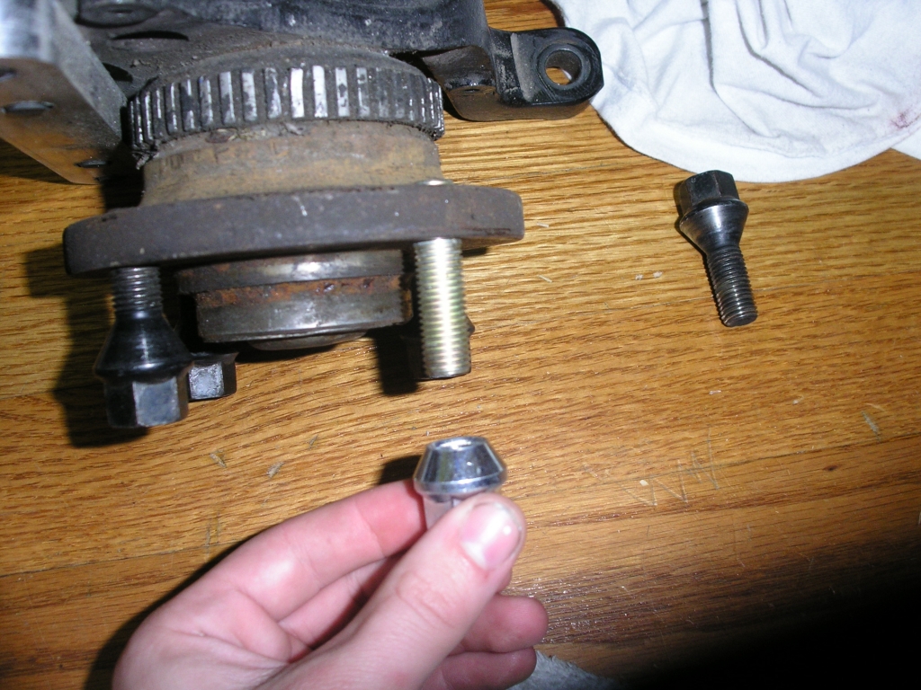

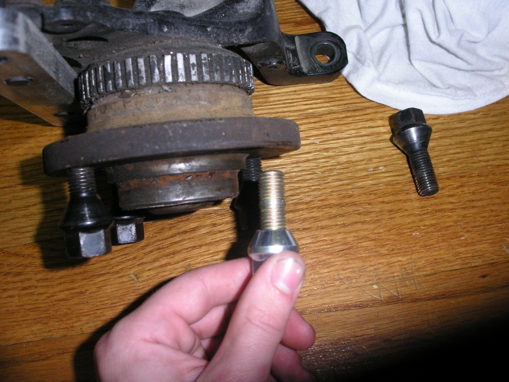

    Well in my case, I will have to use longer studs because of my wheels. The holes the studs/ lug bolts go through are to narrow (the head of the lug "bolt" doesn't fit into the hole of my wheels). So I am basically screwing nuts onto the end of a stud and then screwing the stud into the wheel hub. BTW, does anyone no of any negatives in doing it this way...
    Quote:
    Originally Posted by Axxe
    You cannot do that. The stud needs to be torqued and loctited into the hub, and THEN you mount the wheel and use the lug nuts to attach the wheel.
    Question:
    Can I just have the studs torqued and loctited in with the nut on the end of it? You know what I mean? My nuts are locking nuts and are closed-ended and narrow enough to fit through the holes of the wheels...

              No one has answered my question though. I already own some locking nuts that fit the wheels and I had a store special order me some longer studs. The locking nuts weren't too expensive and I can probably just cancel the order and ask for store credit but I would like to know:
              "Can I just have the studs torqued and loctited in with the nut on the end of it?"

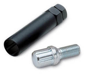

                              The 90 325is has lug bolts which are not only too short to go through the wheel and reach the hub but the head (lug part) of the bolt is too big to go into the hole of the wheel which is where it actually needs to go to tighten correctly. I could have solved this by going with a longer version of this:Click image for larger version
ID:	7098908 but I wanted to utilize the the locking nuts I already own (which of course are narrow enough to go into that "hole" in the wheel) so I went and had some studs ordered.
