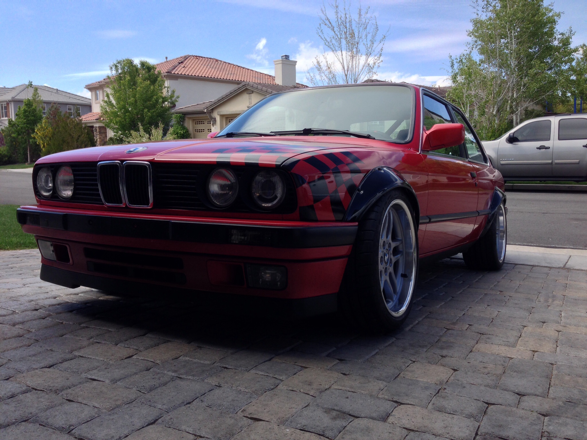

    18x9.5 M-parallels with 255/35/18 fit!
    Lots of work and flares but they fit

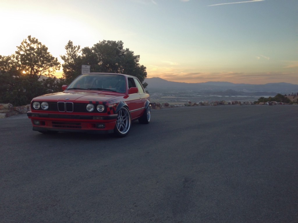

      Only have one bad one so far

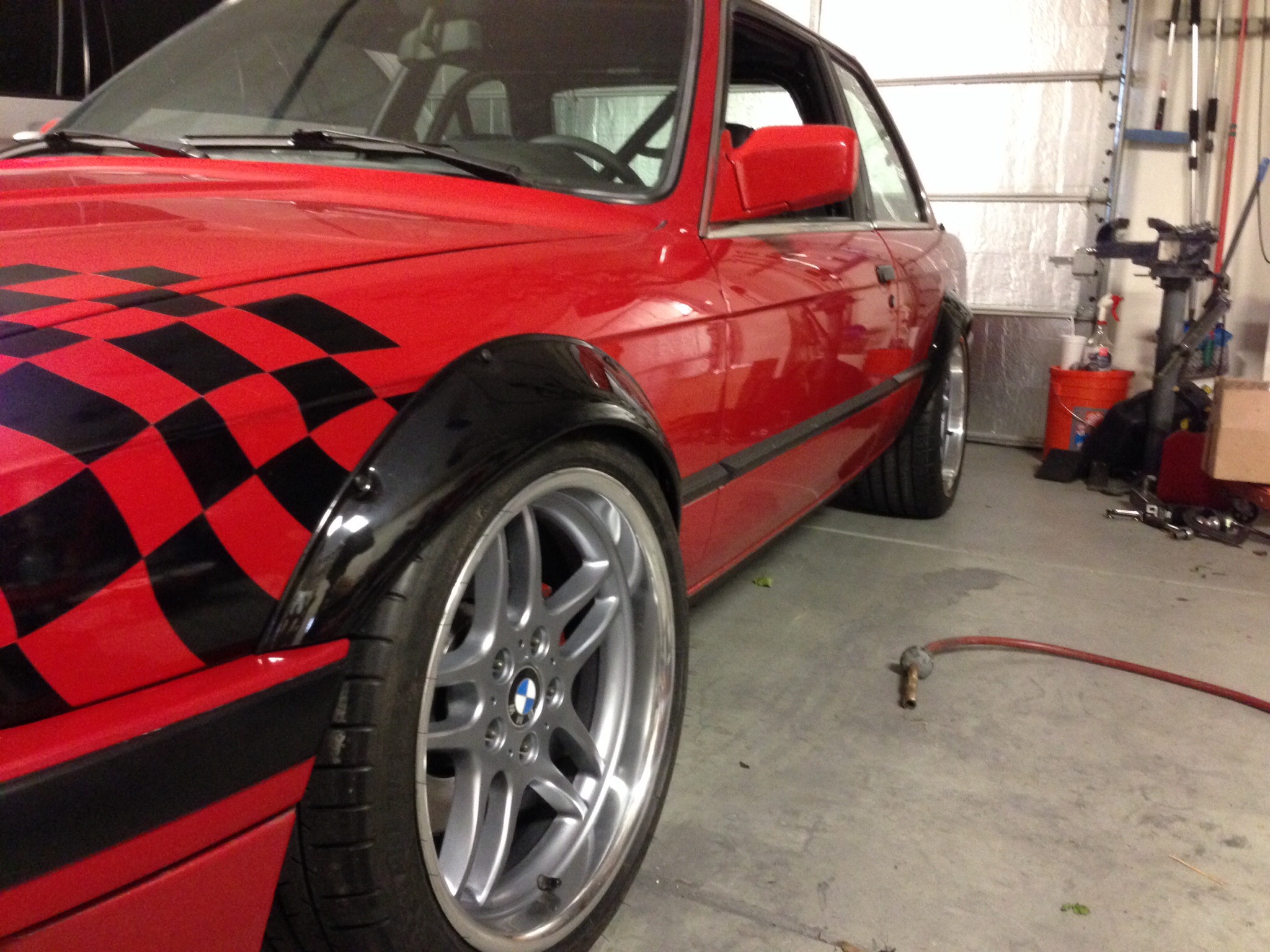

          I am with you I have always loved the M-parallels but I had to make a lot of room to make them fit. 9.5 inches wide with an et of 25 is deep. I could have fit a. 275 on a rear with a ideal et.

              It is tight. There is no more room for tire that for sure. I have a 12mm spacer up front making my et13 but it just barely clears the coilovers (4mm) . I am glad I cut my fenders so high otherwise I would have had to raise the car .

                      With the right back spacing maybe. I need to switch my rear spring rate. I currently have 600 rears and 550 fronts. I am leaning towards 850 or 950 for the rear.
