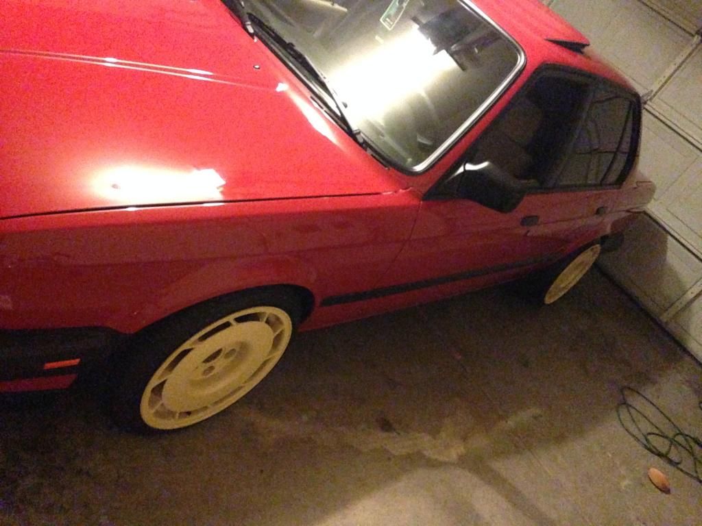

      Well I have found myself a set if shooters 8.5 wide, from what I think I know, I need 18mm adapter in the front and 20mm in the back. My math is terrible but from what I've found is this will keep them "flush" and not poked out.
      How far off am I?

        well i'm sitting on 8.5 with +15 offset and i'd call that the limit

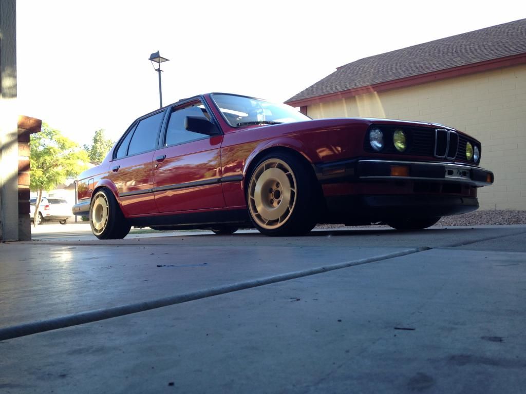

          pretty sure the initial offsets of salad shooters are like +55mm. When I ran the staggered set on my car, I used 25mm adapters and the fronts sat inside the fenders.

            bad pictures but you get the idea

              Cody how big of adapters you got?

                they were 25mm

                  The guy I bought them from ran 18mm in the front and 20mm in the rear and he didn't rub a bit (speed racer 2002). Sound right to you?
                  Thanks for all the help.

                    yea, your set up will be be 7mm Front, and 5mm Rear, further in.

                      Forgot to mention that I'm on h&r race so I'm a good but lower, I need that wheel farther in.
