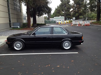

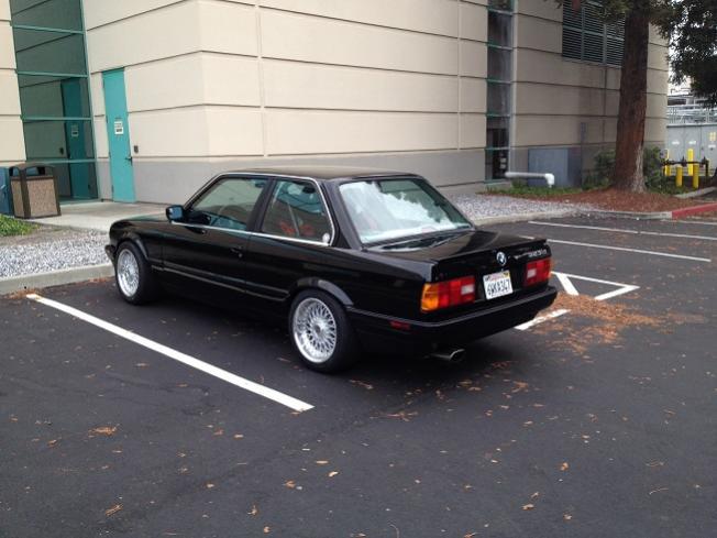

    Hey, I got the same wheel/tire size as you. My wheels came et25, but I needed a 5mm spacer to clear the front coilovers. And I have 15 mm spacers in the rear, but it rubs on big bumps. I'm thinking of getting thinner spacers maybe 10mm. I'll try to get some pics later today.
