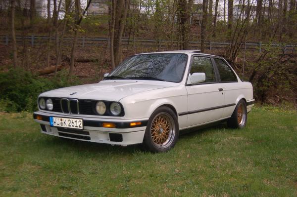

          They will fit just fine. If your car is low you'll need to roll the fenders. I'd recommend going with a 205/55/15 tire.
          Here's my 323i with 15x7 ET13 wheels and a 205/55 tire just to give you an idea...
