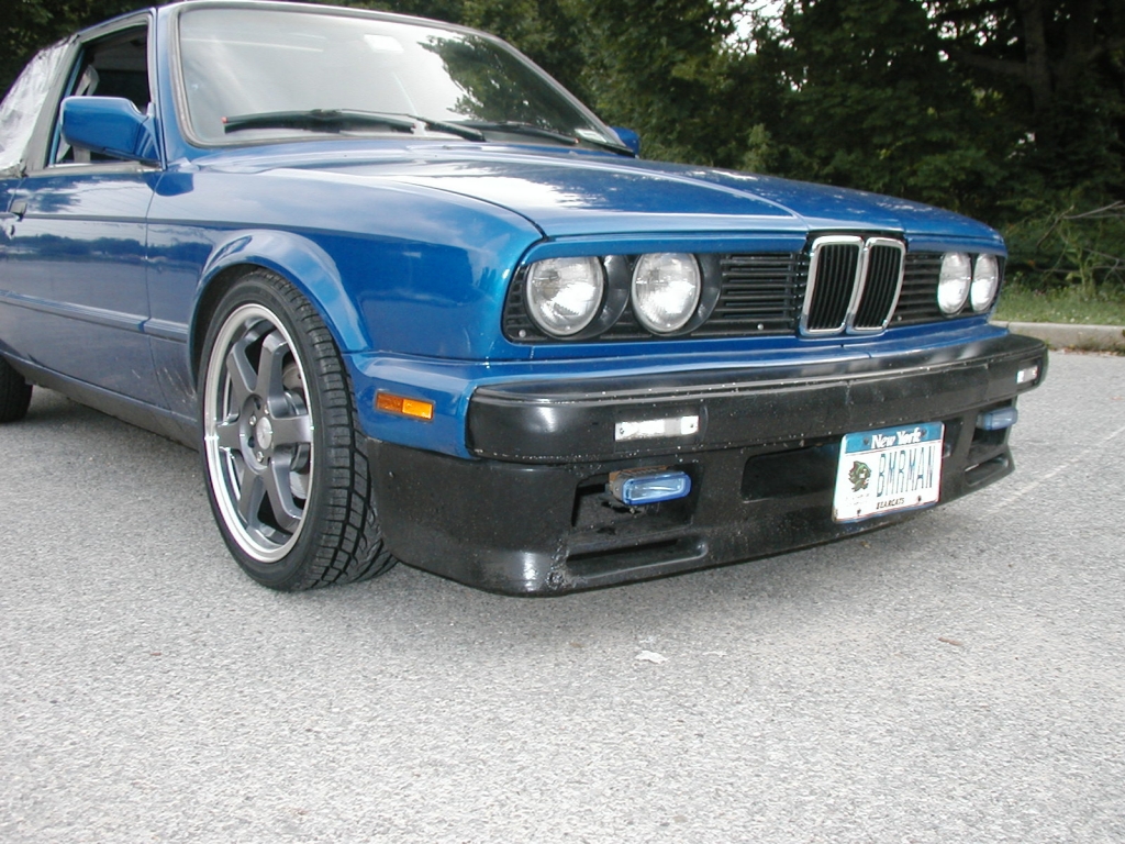

        Those are 17x7 with 40mm offset....... I needed 20mm spacers all around to clear the strut housings..
        If ur wheel is a typical 4x100/4x114 with a +40-43mm offset, then i would run 20mm spacers
        check out the pic, take a look at the spacers...

            I am happy with the 17s on my car. If I were going to get a set strictly for the track, I would probably get some lightweight 16s. I think that 17s look the best though.
            If the offset is 40, I don't recommend getting a 20mm spacer. 15mm would be ideal.
            My wheels are 17x7 with et40 and have a 20mm spacer. That offset is fine if you are not running aggressive tires, but if you put anything wider than 205s, you run the risk of rubbing the fenders.
            I am going to try to have 5mm machined off my current spacers.
