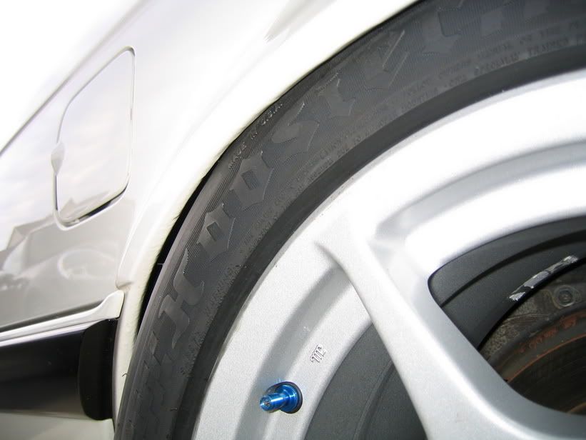

      For what its worth, here's a 225/45R15 Hoosier on a 15x8 Kosei, ET22. Rear fitment required the fenders be rolled ('89 325is), front required about 5mm in spacers and a mild fender roll. Yes, the tire is a wide 225, but the pic demonstrates how marginal the fitment can be.

          Adding to Garrick's post, ET22 is perfect for 225/50/15 street tires. If you're planning R-comps, get something a bit further out.
