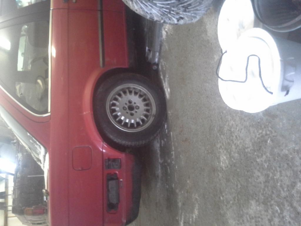

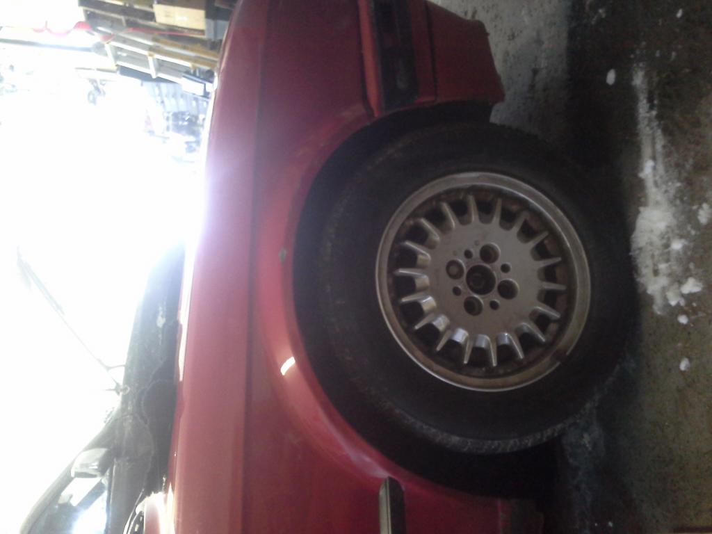

                Heres is the car on stock rims and a 195/65/14 is pretty much the same size as a 225/45/16 right so do you think I could get away with a 225/50/16 ? I want to fill in the wheel gap as much as possible without issues

                  • MR 325
                    • 37833
                    225/50/16 will look too tall for the E30. I don't recommend it.
                    Stick with 205/50 or 225/45.
