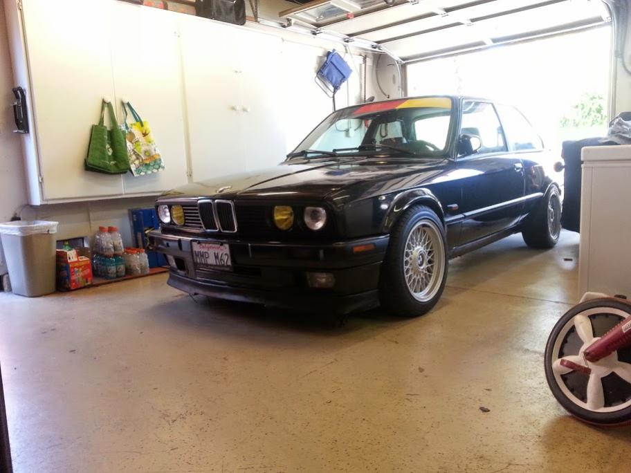

    Surprisingly found a set of 15x7.5 et0 that i would like to buy
    there in my price range and I'm really jazzed about finding them.
    my problem is i would have to run adapters (18-20mm) in order to bolt up
    I was thinking of mounting 205/40or45 15 tires on these.
    my car has a slight drop (springs) nothing radical.
    I'm currently on a set of drill in fill style 5's with 205/50 16's and I'm not
    close to rubbing at all.
    My question is can i fit these 15x7.5 et0 and run 18-20mm adapters and 205/40or45 15's
    this is how the car look now as it sits..

    7.5 +0 AND an 18mm adapter is 16x7.5 -18. The Style 5's you're running now are 16x8 +23. Put 3.5cm on the edge of your wheels now to look where they are gonna sit. Your call, but not on stock fenders.

      So what your saying is that this setup i may want to run will give mt too much poke for my stock'ish setup? Ugh...

        Yeah, it'd be insane. Sorry, man.

          Ok thanks, sadly i guess I'll pass on the purchase of these wheels :-(
