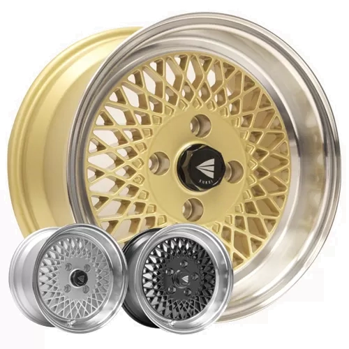

    Can someone help me with wheel fitment?
    I have a 1989 BMW 325ix e30 and I want to put Enkei 92 wheels on it.. I don't really understand how wheel fitment works so I need some help
    Would these fit?

    The ET38 version should fit, but it will push the wheel 7mm out towards the fender lip (stock wheels are ET45). Make sure you have the clearance and you should be fine.
      So the wheel would move farther out? So I wouldn't need wheel spacers? Sorry, I've never bought aftermarket wheels so I haven't learned about it yet, thank you for your help

        And would it be possible to run the 8x15s at least On the rear wheels?

          The 15x8 et25's should fit without spacers, I'm running 16x9 et25 all the way around and only had to use a 5mm spacer in the front.

            ^^^You don't have an iX. ET 25 would put the edge of the wheel like an inch past the fender lip.
            Lowering the offset is like adding spacers. Offset is how far the mounting hub of the wheel is offset from center. Positive is towards the face of the wheel. Spacers effectively give you a lower offset.
