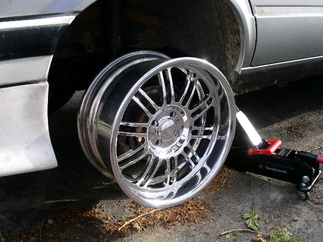

    I am going to powdercoat my spokes to black. They are J-line wheels and are a clear polish coating. NOT CHROME, despite what the pictures look like.
    The guy who is going to do it said that i'm taking a big chance with it because when he bakes the clear coat on, the 400F oven will make the clear coat on the lip bubble because general clear coat paint can't take the heat..
    Is this true? What can be done about it...

          It depends on what the current "clear polish" coating is - -
          If it's spray clear, wont work!! Very few wheel refinishers/powder coaters
          can do a clear powder coat over a paint base coat & do it correctly -- you end up with flaws as the paint base coat can't take the heat when they bake the clear coat over it. The heat drives off more solvents from the paint, that causes the blems as they can't get out through the clear powdercoat when it's baking.
          If your wheel is raw alluminum buffed to a shine then it should't be a problem.
          They need to be cleaned so the powdercoat has something to stick to, then he just does it in 2 steps - one to do the black & one to do the clear.

              The wheels will be fine! It's only on cheap cast Aluminum that you need to worry. I powder coated my SSR GT3's Matte Black for my B5 S4, and they came out Sic!!
              Oh, and you have to have the clear coat sanded off and then have the wheels repolished or they will get jacked up. Only thing is that once you do that, you have to constantly polish and clean your wheels to keep them from getting spots. Worth it in my opinion!
