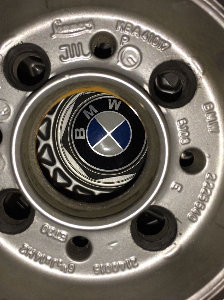

    Hi Guys,
    I found a set of basketweaves and the seller claims they are 15". I did some researching and found that the 4 lug version are available in:
    14" with 41 offset (IX wheels)
    15" with 24 offset (Euroweaves)
    He sent me a picture of the center and it appears to be ET30 (offset 30?) and the wheels show 6.5x14xH2...does this mean they are 14" and 6.5" wide? The seller insists they are 15" that came off his '93 E30 325I.
    Thanks for the help!

    These are OEM 14 inch by 6.5J E30 wheels
      Yes.

        That's what I thought! I was very skeptical and the information given didn't make sense based on what I saw.
        Thanks for confirming guys, I really appreciate it.

          He likely measured the outside diameter of the wheels, but wheels are actually measured where the bead of the tire sits, so it would have measured bigger.
