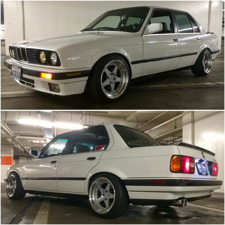

        I'm wearing a 9.5 et13 on my rear… see if this solve your question… my front is 8 et6 …. but i don't know about BBS maybe different...

            Originally posted by M-technik-3
            Stretched 205's?
            Stretched 215 (Nexen Tire only) i'm planning to go 225 soon TOYO R1R
            Ops sorry I thought you where talking to me...
            • M-technik-3
              • 18946
              I was, it doesn't help showing a photo if you don't list what the rubber band is stretched across it.
              That at lease helps OP answer some of his questions and you might list what spring/shock combo and offset of the wheel.
              • crzylildude
                • Aug 2014
                • 332
                Oh ok…
                Front - 8 et6 - tires 205x40R16 Nexen
                Rear - 9.5 et13 - tires 215x40R16 Nexen
                Riding on - CAtuned Coilovers
                That's it….

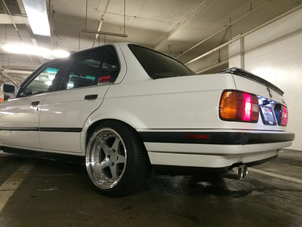

                        Can you please upload more pictures?
                        • crzylildude
                          • Aug 2014
                          • 332
                          Here you go... sorry i know i need to replace my front fenders and need some bodywork ... but she is my gf daily...
                          • staysideways
                            • Dec 2013
                            • 373
                            Lol it's all good. Car looks amazing and almost identical to mine except white mirrors and exhaust tips. Anyways I have major rubbing issues in the back. The front is ok but I am running 15x8 wheels with 12 offset. What I had to do was go get some cheap 185/55/15s just to test fit because I had already sold my basket weaves. And since you are running 9s idk what other options I have. Maybe some help? I would like to drive the car not just take it to car meets.
