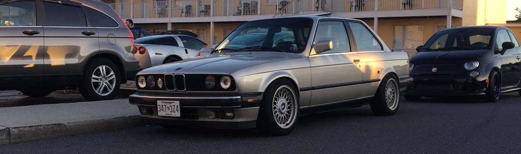

        I run a 205/50 since its all the tire shop had the day I went in. 205/45 will work really well with this setup. Im on hr race and bilsteins. I did have to roll all fenders but with a 205/45 im sure your rubbing issues will be a lot less than mine!

            technically speaking the adapters for you to run a style 5 is a spacer. im running 205/40/16 with an hr cup kit and i get ocassional rubbing on my late sedan. the adapters in the back i had to loctite the studs because they were working their way out. i am either going to convert to e36 5 lug or go back to 4 lug 15's or bbs 4 lug 16"
