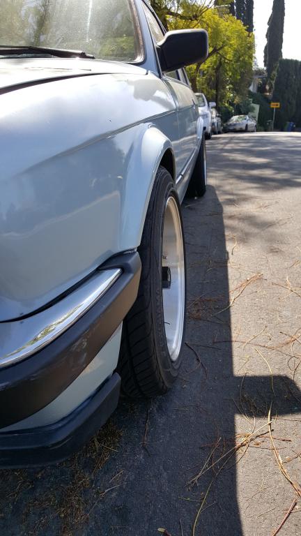

    I think 15x8 0 offset up front will poke about 15mm. You could remedy that with really aggressive camber.
    attached is my car with 15mm offset (25mm offset with 10mm spacer)
