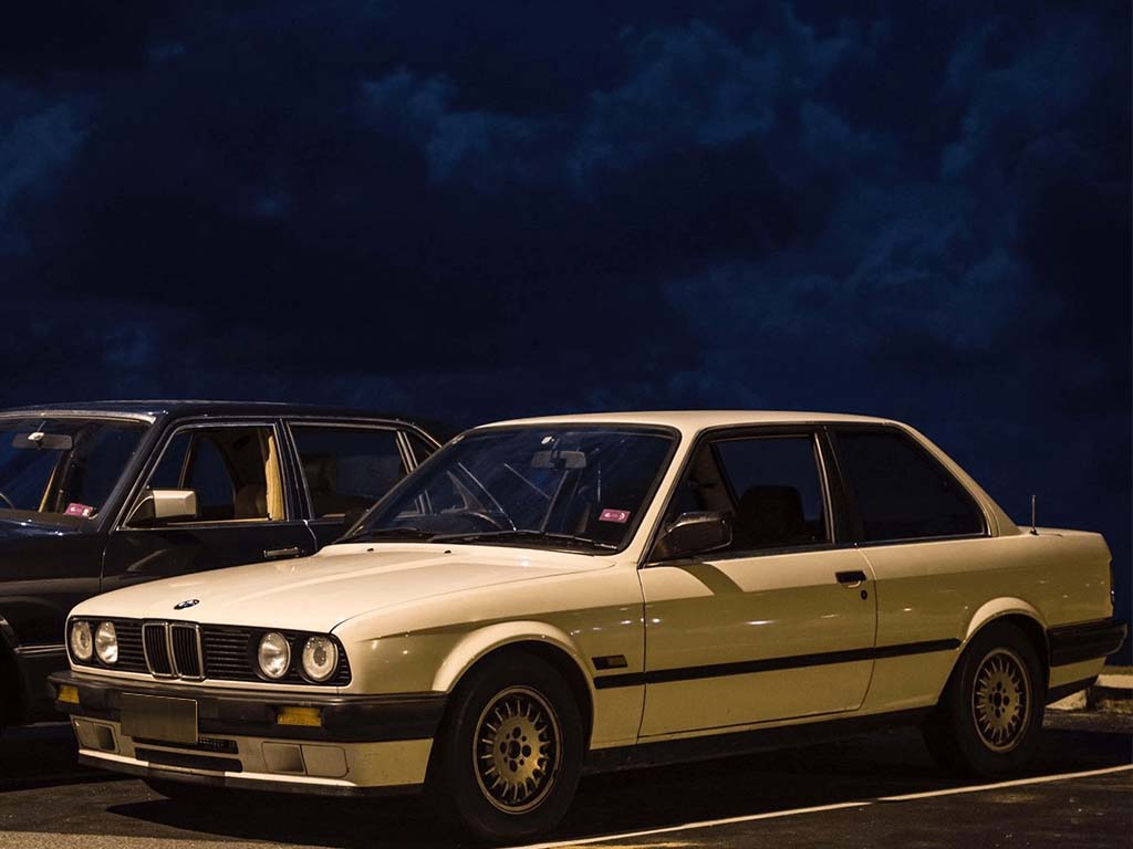

    Hi,
    I've purchased a set of Enkei 92's in 15x8 +25, Does anyone know if 225/50 tires will fit up front without rubbing? I believe I'm on H&R sport springs, so it is slightly lower than stock.
    I also have a 5mm spacer ready for some extra clearance for the front wheels.
    Cheers

    I have an early model 318i, enkei 92 15x8 et25 with 5mm spacers on the front, 225/45-15 r1r no rubbing. The toyos run a bit wide so similar to 225/50.
    Edit... I'll double check my sidewall ratio in a few mins. I might be 225/50
        Thanks, are you on stock suspension?
        • g.ruff561
          • 1268
          I run a square set up of 15x8 Racing Dynamics wheels with 225/50/15 Khumho Esta. No rub lock to lock. No fender roll. No spacers. Direct fit. Stock suspension.
