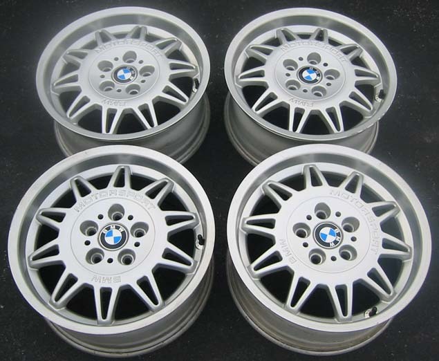

    I really like e36 M3 DS I's(17x7.5", 5 lug). So I was thinking - E36 rims are about +40mm Offset right?
    And on a e30, for a 7.5" rim - something around 20mm offset(or less?) is desired - no?
    So - then I found this guy on ebay that makes custom adapters for $200 for a set of four(VW guys run these all the time with out issue - and this guy makes them for 'dullie' trucks as well, so I think they will be fine)
    So why not a 20mm spacer/adapter that converst 4-to-5 lug so I can mount these rims up?
    So, anyone see a issue with using a 20mm adapter plate and e36 rims?
    PIC

    it would work
    but adapters are HEAVY
    we're talkin an additional 6-8lbs per corner

      I've talked to one guy about the adapters...he said
      "That would have to be a two piece design....the thinnest that I can build them is 42mm thick"
      I'm guess the bolt patterns interfear with eachother...hence the two peice design

        • BahnE30
          • 1050
          well if the thinnest he can make the adapters is 42mm and the offest on the wheels is around 40mm. my guess is you'd end up with around a final offset of 0mm which may be doable my not, you'd need alot of camber and serious fender rolling. but i think it would be doable.
