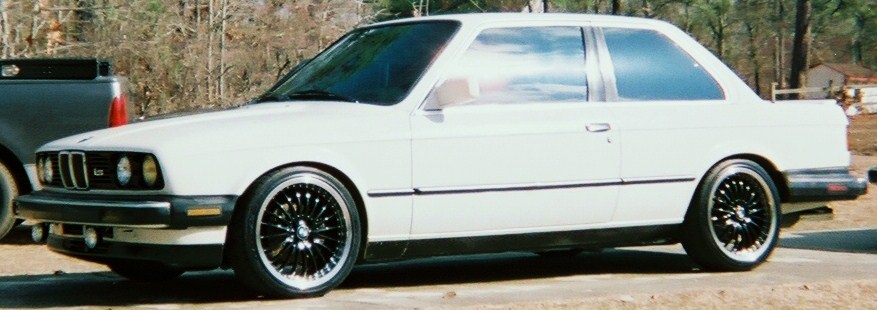

            I have 17/7 with an offset of et 25 with 205/40/17's with no rolled fenders and lowered suspension with no problems whatsoever and plenty of room.
