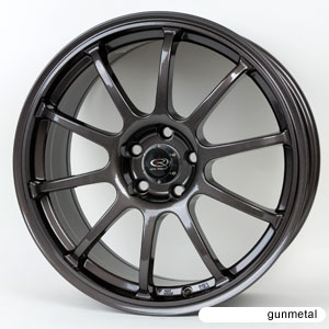

    What about these wheels?
    What do you guys think about how these would look on an E30 in 17x7

        I like black centers on wheels but in my case if I go with these they would be going on a black/black car and black centers on the wheels personally to me is just way to much black. I think the wheels for my car needs to be a silver center or maybe steel gray would work too to help set the car off some. I had a black infiniti Q45 that had 17" silver macking gewalt wheels on it and the contrast of color was needed on it as well.

          or I can go with something like this in a 17x7.5 et35 with 10mm hubcentric spacers with possibly 225/40-17 tires on h & r race springs couldnt I? Any suggestions finding wheels for an e30 is dang hard to do.
              Or - no spacers and 235/40/17 tires without rubbing. Something to think about.

                wouldnt a et35 wheel get me to close to the struts for a 235/40-17 tire? this wheel/tire combo stuff is more confusing than advanced math classes in the 4th grade.

                  Not with a 17" wheel. That setup will work perfectly.

                    everyone says on here that you know your sh.. so thanks a ton man. Thats what I have been wanting to run is a 235/40 all along and knowing a 17x7.5 et35 wheel with no spacers allows me to run this means all is good. You still see no problem with a koni adjustable setup with h & r race springs with it as well right?

                      Yup, no problem at all.
