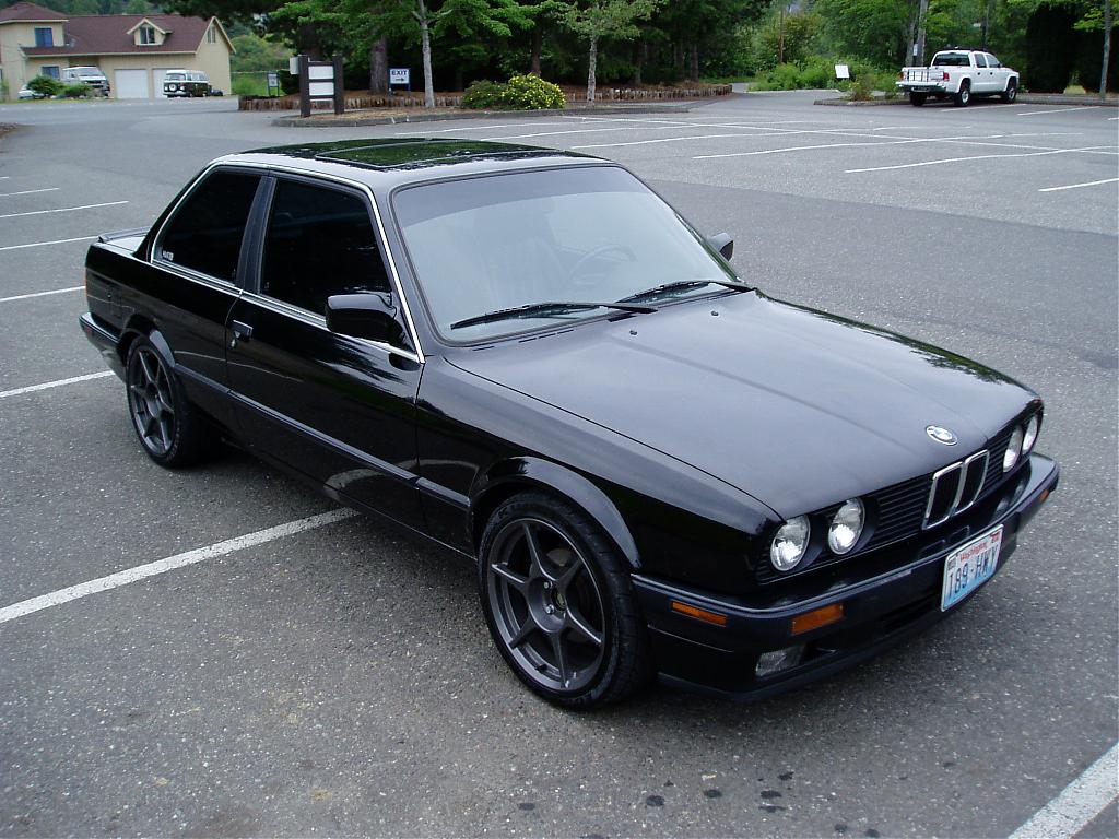

                        For a street car I would go with 17's as they look the best, but the ride is more harsh. Here's a pic of my wife's 325is with 17in Kosei K1's, they arent too expensive and they are fairly light. Also in tht catagory is Team Dynamics wheels, Pro race 1 and 2, light and cheap. I would consider one of these as they are cheaper and wont rob acceleration from your car. Bimmerworld.com has them.
                        As for tires, I was a bit dissapionted in BFG KDW's (but that was the old tread pattern) very spendy and not any better performance than cheaper tires. Falken Azenis (again, the old tread pattern, but I heard the new is very similar) was the fastest street tire I have owned (in the dry...scary when wet), even faster than many R compounds in autocross conditions. But they dont last all that long. I just corded a set of Kuhmo MX tires after 20,000+ miles, and that even included 1 track day and 3 autocrosses on them. Not quite as fast as Azenis but they had plenty of grip, a good stiff sidewall, did reasonably well when it rained, and lasted longer. Not the cheapest tires, but not the most expensive either. I just bought a set of Yokohama's Parada Spec 2 tires in a 215/40/17 for the K1's and I have barely scrubbed the mold release of of them so I don't really have any immpresions of them yet except that the price is not bad at $84 per tire and the 300 treadwear will likely allow for longer life.
