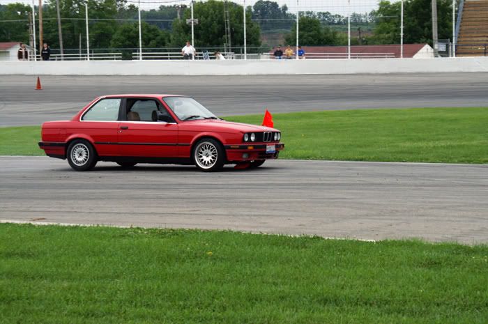

                    • ZinnoE30
                      • Jan 2008
                      • 109
                      Here's he car.....
                      • Erick
                        Official R3V Drifter
                        • 11169
                        Yeah dude, that's kinda far away lol. If that's an 8, I'm taking a step at it for +20 offset.

                          • Erick
                            • 11169
                            Still too far away to guess. I still would say no on the fact that you're on a Pro-Kit.
