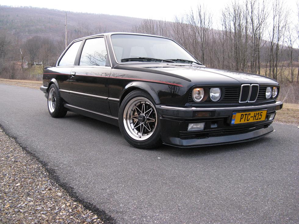

                    Well, you was right about them hitting. I just took a grinder to the caliper. They clear now. I still have to roll my fenders. They are very close to them.

                      195/55/15 should be okay. Especially if they're Falken 512 or 912 (just guessing, because of the stickers on your car).
                      Jason, that looks pretty damn nice.
                      Jay

                        so you have no spacers? dam that looks bomb. whats the tire specs? were your front bolts to long? and will you need to roll the rears? or just the front?

                          The tires are 195/55 Falken Ziex ZE-512. No spacers, i just ground on the caliper. The lugs i didn't get from him (since they never showed up), i found some else where. The front it's really tight so i'd roll them to be safe. The rear i can fit my fingers between the tire and 1/4 lip.

                            thats bomb! i think i an getting the same tires, i can get them $420canadian out the door on the rims. i rolled the little edge on the front of my fender on one side (didn't get to the other side yet) so it wont catch it not sure if its enough well see soon!

                              Keep in mind his rear fenders give him a lot more room. Roll yours well.
