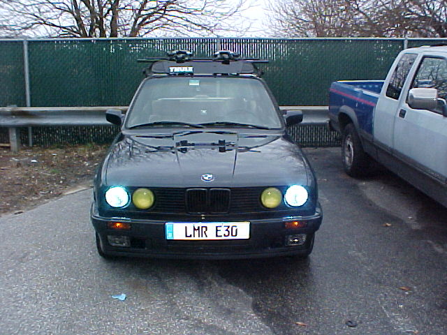

            So if I go with the 205's on the 16x8, is it gonna have a "pansy look to it?

              lol @ pansy. It'll be slightly stretched, here's a pic of a 16x8 ET15 with the same sized tire:

                The et-15 sticks out less than the 20 would, correct? Sorry, Im a Jeep guy and not used to dealing with this stuff. And what if I wanted the tire slightly wider than the rim? What then?

                    the et15 sticks out 5mm more than an et20

                      Yeah ET20 will be 5mm further IN, and to raise the rear you can use 9/10mm spring pads in the back. Do a search on here, they're available from the dealer. Oh, and if you want the tire wider than those rims, you'd have to roll the fenders.
