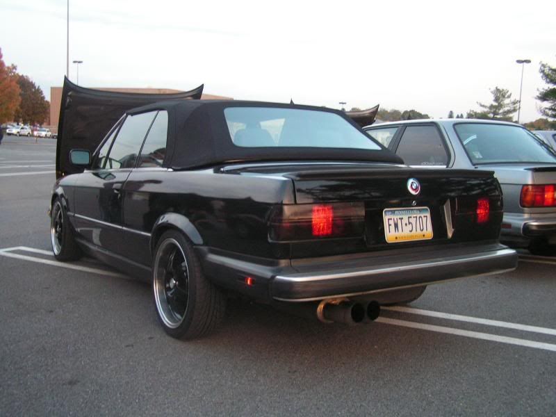

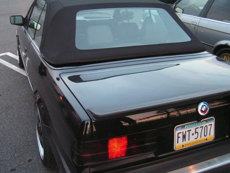

I was running some 17x7 wheels et35 and they were extremely close to the strut tower in the front, almost rubbing against it. I installed 20mm in the front and 31mm spacers in the back and the stance was awesome with a 1.6 front drop and a 1.2 rear drop, here are a couple pics:
