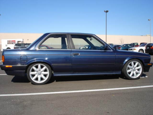

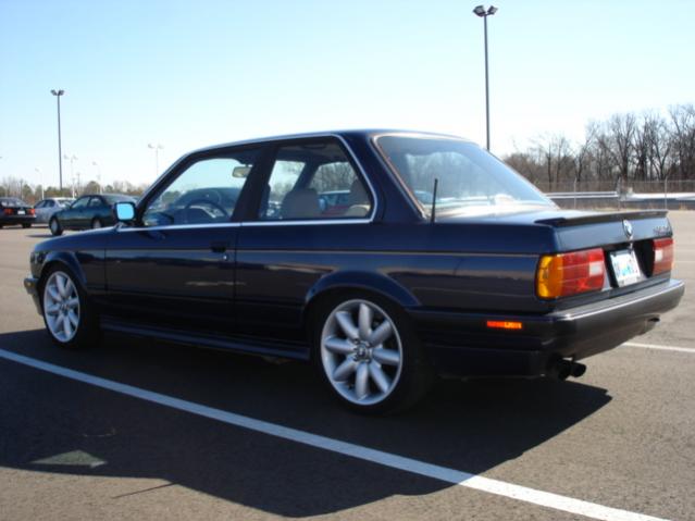

    I was wondering if the mini cooper wheels fit on an e30...they come in 4x100pattern, I dont know what offset they have though, and if it would be possible? ...just wondering

    They do fit. They're a high offset wheel, so you're going to want to buy some spacers.

        I think they look good. I think the hub is a different size though.
        COTM
          Centerbore on MINI wheels - 56.1MM
          Centerbore on E30 hubs - 57.1MM
          Offset on MINI wheels - Something crazy like 45MM or something.
          Easiest way to make MINI wheels fit on an E30 is to get spacers that aren't hubcentric, so they'll fit without boring out the center of the MINI wheels.

                        On topic - I'd never seen the MINI wheels on an e30 and I have to say i like them. The only issue is the width is probably 6" and they are heavy too.
                        I think some of the other MINI wheels would look even better. They have some 15" ones in white and black that don't look too bad.

                            Wheels on the above car are 17x7", and yes, they are very heavy :) I still love them on my MINI though!
