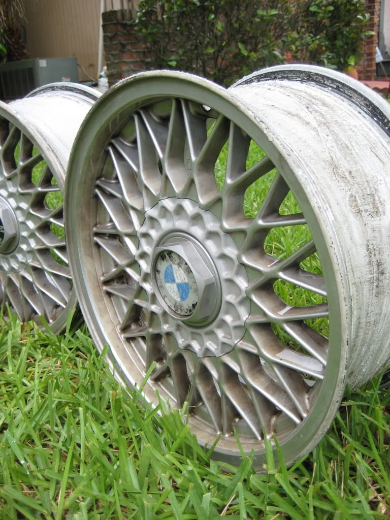

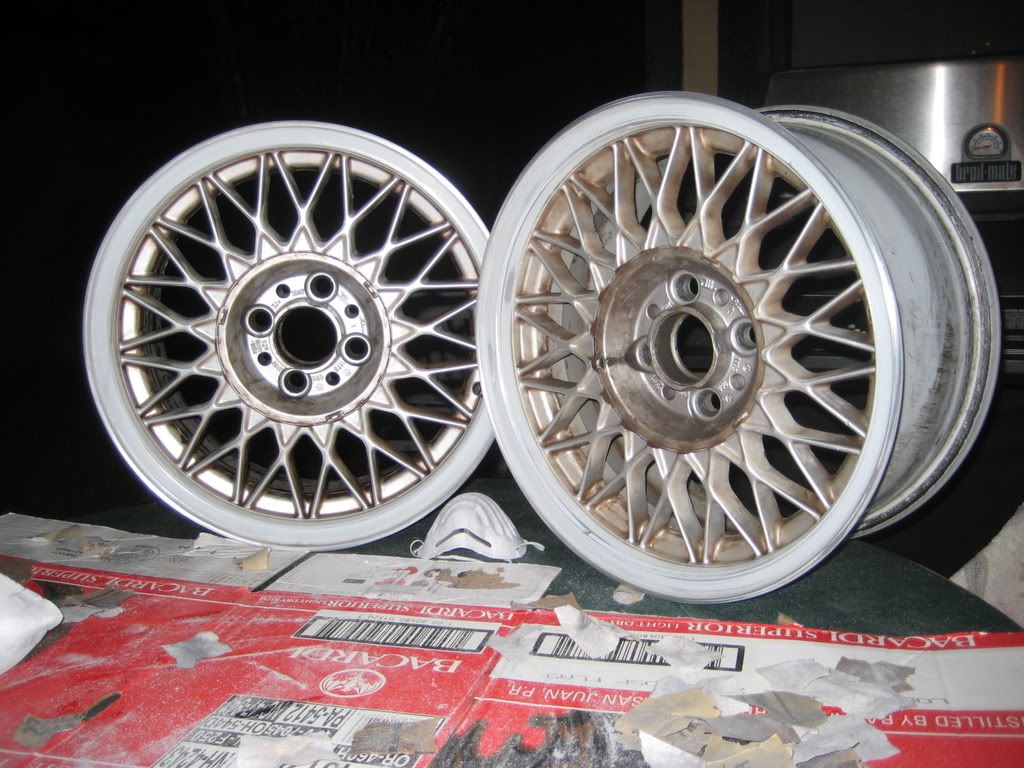

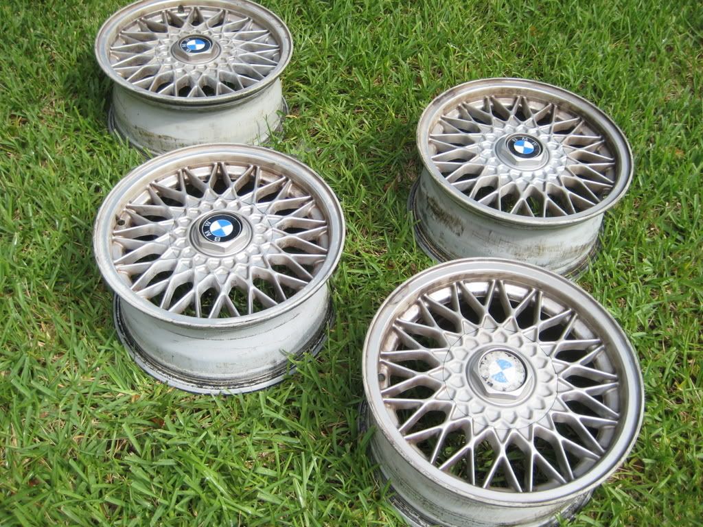

    Hey guys, i picked up a set of pretty beat up euroweaves a little bit ago. Since then Ive gotten all of the curb rash out and have been working my ass off to get all of the paint off. 19 year old primer is'nt the easiest stuff so im taking them this weekend to get sandblasted. The question is i don't know what color to paint them. Colors im considering:
    1: Silver w/ polished lip.
    2: Silver w/o polished lip.
    3: Gold w/ Polished lip.
    4: Negaro w/ polished lip.
    Tell me what you guys think and if you have any pictures of alpines with weaves post them please.
    heres some pictures of the wheels and my car.
    when i first brought them home..
    pretty bad curb rash.
    no more rash..

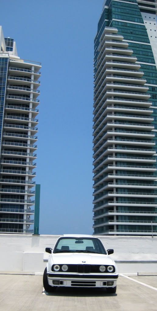

    and my car..
    thanks.

          Yea, that's not primer you were sanding through. It was epoxy paint. Shit is thick as hell. I just use either a sand blasting cabinet or Aircraft remover.
          My 2.9L Build!
          Originally posted by Ernest Hemingway
          There are only three sports: bullfighting, motor racing, and mountaineering; all the rest are merely games.
          • soflawussbag
            • 177
            i wasnt sanding it i sanded the lips to get the rash out. I was using the gel paint stripper. Do you think i should try the aircraft remover before i pay to get them sand blasted?

                  The gel stripper is probably the same stuff as Aircraft Stripper, just not as strong. Hell, the Aircraft Stripper won't pull all of the epoxy off. Just get them sand blasted or media blasted.
